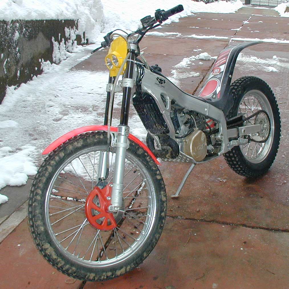

Just bought a 98 Montesa and have some questions:

Also, i think your bike could be a 99' spec because it has Black fork stanchions (as opposed to chrome on 98's) and Black rear fender (Red on 98's).

The next trial dealer in my area is about 200 km away from me, an the montesa is a very rare bike in austria. The fork stanchions have a strange color -they really look black on the picture, but sometimes they look yellow? (or kind of Titan-color) no choke :-)

would also agree that its a 99 bike you have! 98 had silver sorks
