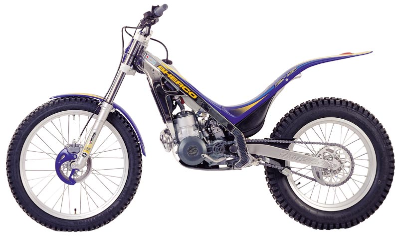

Here's what I think the 80 Sherco will look like. If you give me a side view of the Hodaka engine I can Photoshop the bikes together (while not technically accurate, it will give you an idea).
That looks like the Sherco 80 allright, but I don't have a side view of the engine. Will take some pics saturday will be my first chance. The extra cool downtubes are needed because they are cool! :rolleyes: Really I have been dreaming of building them for so long it's neat to see them fleshed out finally. OK back to work.
