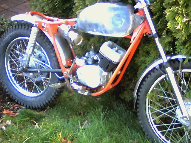

While the "engineer" side of me worries a bit about the combination of the "bent down-tubes" (which aren't tubes), the length of those front frame members and the hardware store variety of the aluminum bar (usually dead soft) - the "experimenter" in me is tickled pink watching this project from the side lines (and I agree that bracing to the front of the engine is a good idea . . . and further, I sure don't have any clear recommendations on how to handle it any better for low bucks on the first design iteration.) It is coming together!!!! If it turns out that the added front frame members need a tweak later . . . so be it . . . just let me know when the queue starts to form for test rides!

oh yeah, sometime why don't you take a full (direct) side view photo of the machine so we can see a sort of "engineers" view?

. . . and just one more, "Oh yeah" comment. Didn't I see a pair of genuine Hodaka head braces bolted up? Which will be big time brace/stressed engine frame re-inforcements! So the front frame members will just be helping out a bit - could be A-OK.

Some purists might be outraged by such a project. Normally I too find engine swaps to be a distasteful subject, but... after several years trying to keep from doing this, I just came home from work one day and started in on it. I guess the winter weather has effected my judgement.
The front subframe has been welded together out of alloy strap material from the hardware store, and short chunks of renthall handlebar. It's very satisfying to be able to make something like that, finally having a tig welder to play with.
The project has a long way to go, but should prove to be a fun ride and a great conversation starter. Also perhaps a handy excuse for lackluster finishes in modern events. :rotfl:
Just a thought...............wonder if you have enough clearance between chassis/exhaust and front mudguard, when forks fully compressed?
