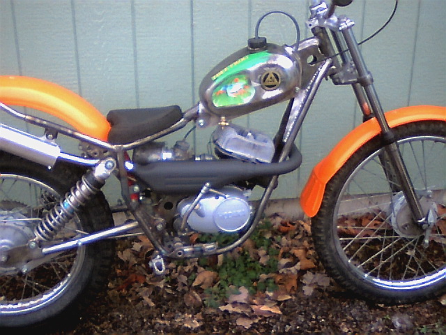

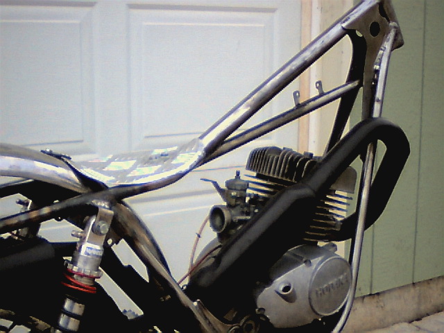

Here's the latest photo as the project slowly inches forward.
Remind me to bring my M92 exhaust over to you for some much needed "help".
Is that a cardboard gas tank? Don't think it will hold up too long. HAHAHHAHAHAHAHAHAH
That exhaust looks very well done. But somewhat curious why you chose to go to the opposite side and then back over the top of the engine. To protect the header maybe?
When you bounce the front forks down does the front wheel/mudguard not touch the new frame? Looks as if it will be very close.
I routed the exhaust that way to get longer header pipe, which ought to improve the low end. Otherwise it would be allot shorter. I have no data to back it up, but the old story goes that more header pipe volume improves low end. Truth be told I think it just looks more trialsy, and it helps to fill in some of the visual voids in the front. Yes the cardboard tank should be all the rage next season. :banana2:
The front fender just touches the subframe on full compression. I have allready pushed the forks down in the clamps to flush, and ground the front corners off the alloy subframe and it still just touches the fender. I have decided to lower the front fender about 1/2 inch closer to the front tire, which is just enough to get it to stop contacting alltogether. Since the engine is just plain longer than the original one, this is a minor problem which is not easy to resolve any other way.

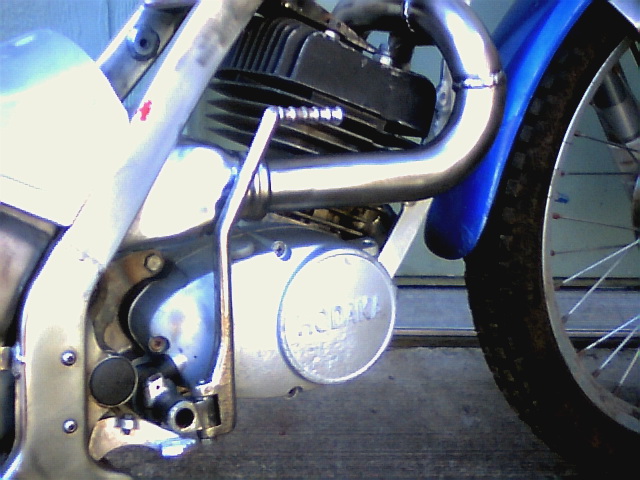

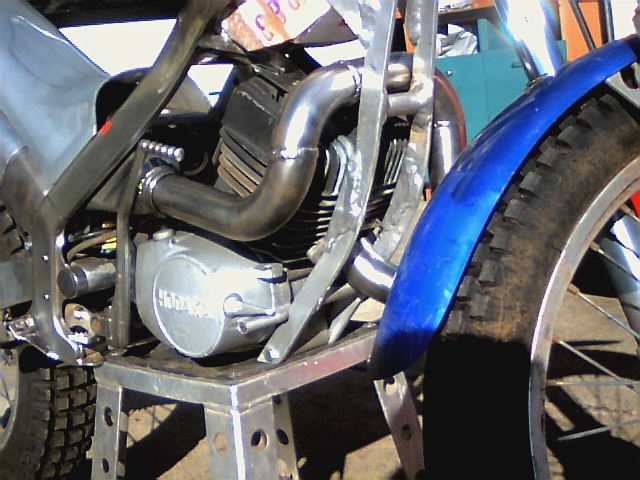

Some purists might be outraged by such a project. Normally I too find engine swaps to be a distasteful subject, but... after several years trying to keep from doing this, I just came home from work one day and started in on it. I guess the winter weather has effected my judgement.
The front subframe has been welded together out of alloy strap material from the hardware store, and short chunks of renthall handlebar. It's very satisfying to be able to make something like that, finally having a tig welder to play with.
The project has a long way to go, but should prove to be a fun ride and a great conversation starter. Also perhaps a handy excuse for lackluster finishes in modern events. :rotfl:
Looks an interesting project, and I wonder if the original motor meant the s/a spindle mounted through the back of the engine cases?
Yes. The original engine has a cast lug for the swingarm bolt to pass through. At one point I had envisioned just building a mount/adapter to theHodaka engine which did the same thing, but Idecided I could achieve more strength and rigidity with the mount welded solid to the frame like a Hodaka. I suppose this thing is strong enough the front downtube arrangement could be taken off without any ill effects. Tempting, but then it weighs almost nothing, and adds that extra assurance the frame is not going to bend upward.

Worth making sure your gearbox sprocket is as close to s/a pivot point as possible, as the further it is away the more difference suspension movement is going to have on chain tension, which in turn is going to alter how well the finished bike is likely to grip in slippery conditions.
"I have no data to back it up, but the old story goes that more header pipe volume improves low end. "
"I hope to use a shorter inlet tract between the carb and reed, and reed to cyl. should be short as possible. The long intake is supposed to increase top end. "
I've usually found that a slightly smaller diameter initial headpipe (less volume but different pressure/pulse/velocity pattern) tends to help bottom end, but this is a one-off project and as mentioned before, theory can be displaced by reality. The computer programs I use for exhaust development are only a tool that incorporates a baseline theory to get one "in the ballpark" and helps with the math, but a good ole cheap stopwatch is the final answer to if it really works or not.
I wouldn't worry too much about the carb mount at this time. The intake tract on a Trials two stroke is a balancing act in a way in that a relative slightly longer tract will tend to help bottom end but a smaller volume in the crank area (which in a non-reed valve engine includes the whole intake tract) tends to also help bottom end by raising the "primary compression ratio" (ratio of the crankcase volume to swept displacement, which affects pumping pressures through the intake ports). The ratio of the combustion chamber volume at TDC to swept displacement (generally "corrected" by measurement from the top of the exhaust port) is actually the "secondary" compression ratio in a two-stroke.
I think what all my psuedo-intellectual blah-blah means is that on a one-off project you need to essentially design and fabricate to fit and it can always be "adjusted" later if need be, as it usually does. I love to see people do projects like this, it's kinda like "rolling art" in a way and it's always interesting to see how they've solved the problems that normally come up in a frame/engine swap. I'll be following it's progress and very interested to see how the test rides turn out!

I have built and ridden three similar vintage machines previously which have given me a fair bit of good test data as far as engine performance. As time goes on I intend to play around with different pipe and carb configurations some more. The Sherdaka is going to get a dellorto 26mm carb for example. You are right about smaller diameter header pipe improving low speed resonse. (I think that's what you said) as the reality of prior tests have bourne this out as fact. I refer to the difference between response at near tickover, and "low end" which is really an innaccurate term, very hard to quantify. I'm not sure I even know what that means in reality.
I have tested several different cyl. heads, and cylinders over time and definitely feel as if I am getting the best combinations narrowed down. I have been very pleased with the iron model 94 wombat cyl and the amal mk 2 carb with the old Gem reed valve, and an O3 cylinder head with no head gasket and anaerobic sealer used in place of a head gasket, applied sparingly. The silver paint thing did not work well for me, developing a combustion leak over time. (Yes the surfaces were flat lapped and torqued to 18 ft lbs.) With this combination the orange and green "Tree-Frog" runs really good and the compromise is just about right. It has schnurle loop scavenging accomplished by ports hand cut by me in the cyl running up from the intake passages to the transfer port height so they all pop open at the same time.

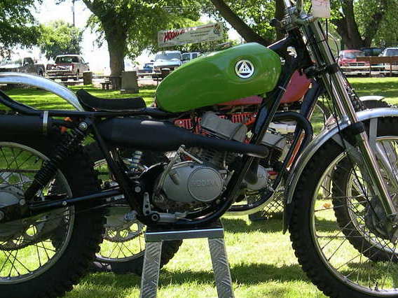

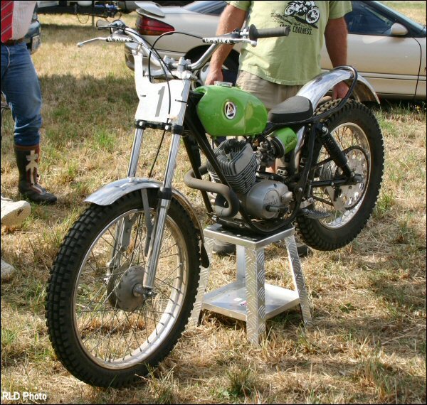

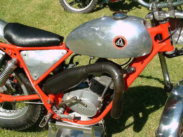

The Green bike with the black frame is Tree-Frog type 2. It uses an aluminum cyl and head directly off an O3 Wombat with no significant mods. This also runs just amazingly well as it is. This is the same basic engine which will be used in the Type 4 or "Sherdaka".
In case anyone is not familiar with them I shall post photos of these prior efforts. I can allready hear Andy thinking, "Dear God, No!" :rotfl:
Anyway I had a brain fart ewhen I ordered inch and three quarter exhaust tube which was technically the wrong size. Once it was bought and paid for I decided to go ahead and use it. You will note there has been in prior efforts, a two inch, two 1 1/2" and now two header pipes made from 1 3/4" tube. The smaller diameter ones seem to be snappier off the bottom and really work nice at tickover roll on. Seem as if bigger carb and bigger pipe both give it more top end at the expense of this sweet chugging torque at slightly off idle. The bigger ones will cause a bog or flame out on snap throttle under load. Any road I guess I've rambled on enough for now.
I agree. Good advice for sure. The engine is jacked back as far as it can go.
