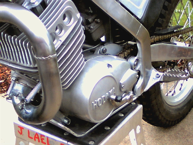

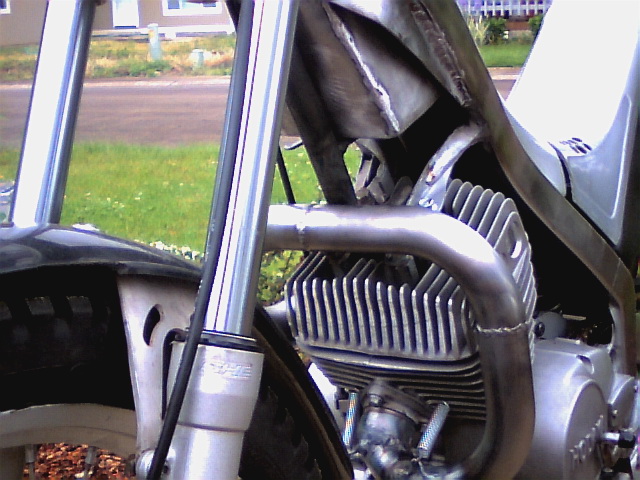

It has been awhile since I posted on this project. Here are a few photos of the current bike. I had allot of re work to get the bike done and now it's about where I thought I was before. I guess I thought if I wished hard enough the front tire would clear. Whatever the case I am now looking back at the series of events which led me to here, and it really has been fun overall. I needed to secure the front of the motor in order to build the back part and the head stays, so in a way my first effort was simply a jig, and a source of welding practice time.
Looking at the photos one can tell that I have long harbored a good deal of fondness for the Mecatecno Dragonfly and Skywalker trials bikes. This Hodaka should sort of help to satisfy that longing to own one of these fascinating and rare spanish bikes. The top of the engine head is secured to the brame steering head area, with a straight piece of chrome moly tubing which was scavenged from a scrapped 1982 Maico frame, (so it's German quality steel) and it has been tig welded very solidly. I think it should be strong enough.

Is the front fender not clearing, or is it the tire?
Would different front forks help? Or shorten the travel?
Is it hitting the engine or the exhaust?

The front fender is an old preston petty. I trimmed it to match the contours of the Sherco fender at the ends. I think I can heat it up and bend it down in back which will look better. The Skid plate looks to be done. No rubber mounts just bolted up to the sherco mounts in back and custon mount brackets to front of the engine. This should be sufficcient for what I want to do.
Dave, It doesn't hit now. Before is when it used to hit. A good bit of the front of the cyl. head had to be ground off as well as eliminating my flat strap front subframe and redoing the header pipe to clear. Now I can tune the forks to best performance for my weight, and still not have the front tire collide with the engine, frame or exhaust on full compression.

I just cannot see that it is triangulated well enough to handle a 6ft drop off without pulling the top end off the motor! <_<

I believe it's gonna work fine for your intended purpose , ie , fantic and many others have used the engine as a stressed member of the chassis .... And besides , all it can do is break !!! So you make some accurate chassis measurements, (footpeg to front axle , tripleclamp to top shock mount etc.) Then fire it up , take her out and abuse her a weebit , then check all your reference measurements and see if anything has changed ! And I'm sure you know that if it does change , find out why and customize ! because as it moves , it fatigues and gets much weaker !!
