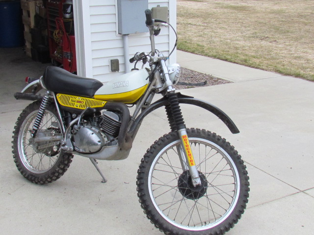

Tony,
   Your old thread post concerning the riding position advice has me wondering.  I too am not so comfortable on my pegs if I use the rear most mounting position for the pegs. 041.JPG.430d9c4fb475f760913d07d9967f0f13.JPG and I did not know there was a difference in the frames between a "Cat" model and a regular TY 250 A.  IS there an easy way to tell which frame I have?  It came with removable footrest brackets that move the foot rests forward about 4 inches for trail riding while sitting on a big cushy seat (which also came on this bike)
