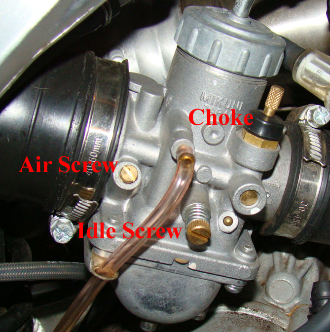

Now you have a leanness in the idle circuit. Normal is roughly 1.75 turns out. Try adjusting the mixture screw a little in either direction to see if the prob goes away.
which screw should b approx 1.75 turns out (screw where airbox meets carb or tick over screw) ??
Air Screw should be adjusted.
My mate sorted the problem on saturday, after we managed to get the bike revving niceley, as said previous, it still kept bogging at low revs, tried adjusting mixture screw with no joy. My made opened the carb back up and lifted the needle (clip i think) to the middle. Bike seems to be running great!!!! So i had a few hours playing around on the mountains. Thanks for your help boys!!!!
