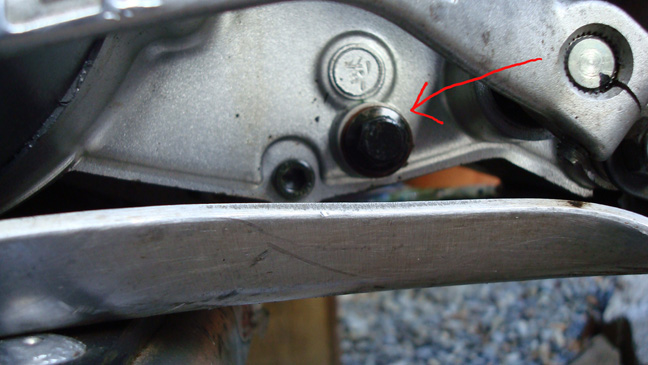

I have been draining oil from this bold for months, no problem, just lean the bike over.....oil drains out in 15 minutes!.....no doubt there is still some oil inside, but I change quite often, so oil is quite clean .......here is photo
ooops, forgot to click UPLOAD button!
