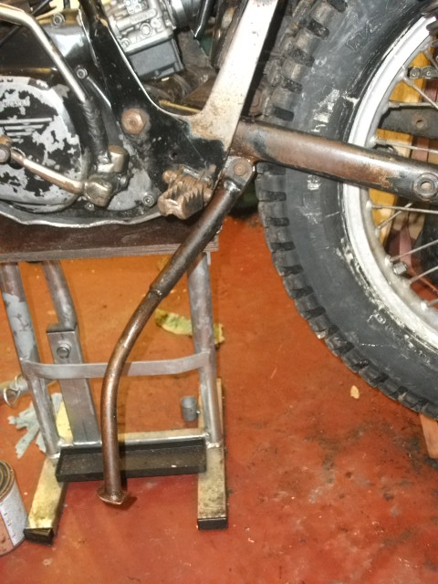

Can anyone help me with the dimensions and shape of the pivot bracket for the propstand off a 320TL. I am about to strip the paint from the frame and swinging arm and I thought that I could replace the bracket that was missing when I purchased the bike. Judging by the weld that's left it looks like it was 35mm long and 5 or 6 mm wide where it fits onto the swinging arm. I haven't been able to take a photo of it but will add one if I get the chance. Thanks

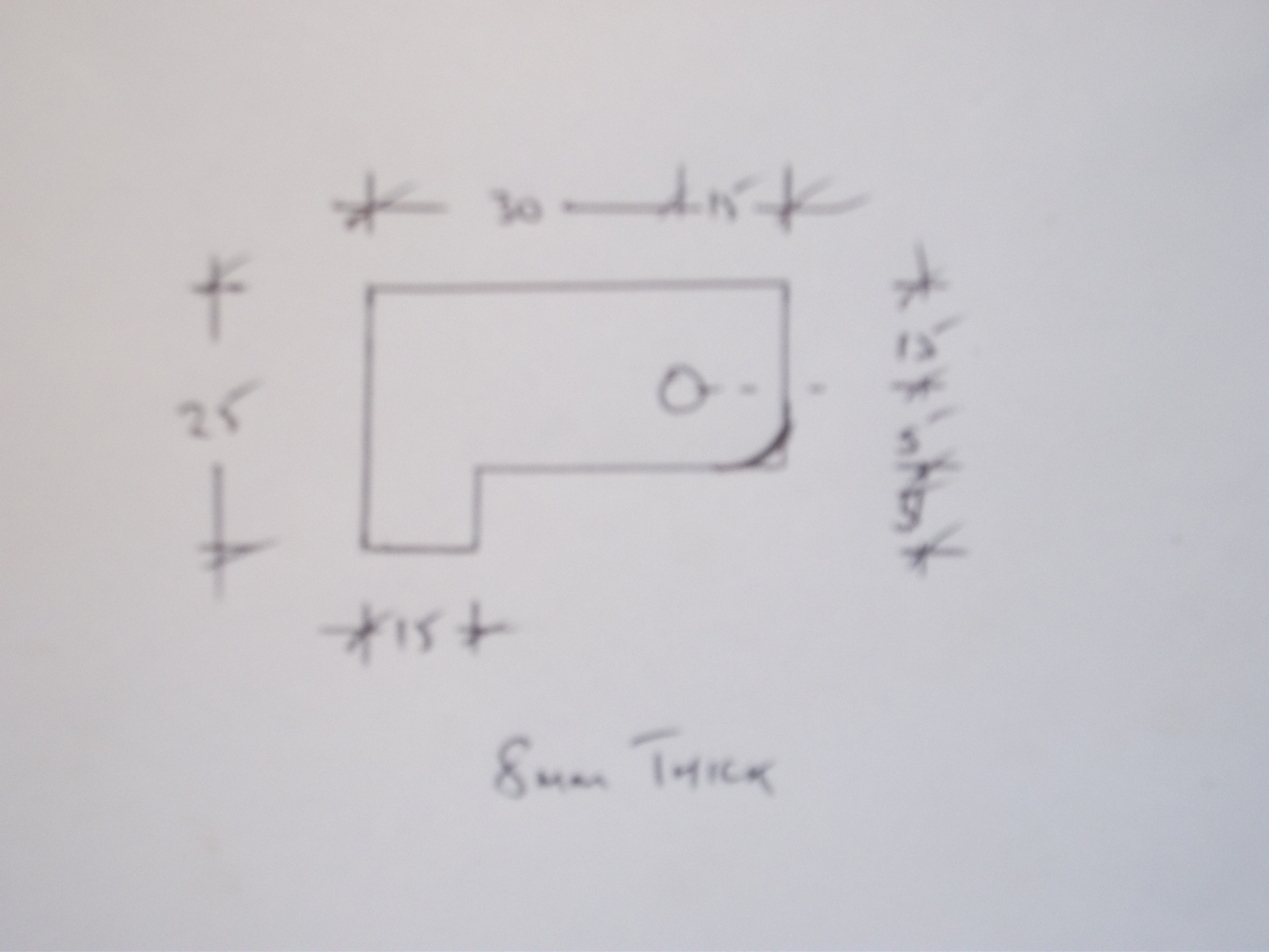

Hi Ross, thats just what I need thanks very much. James
