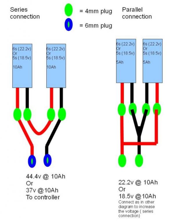

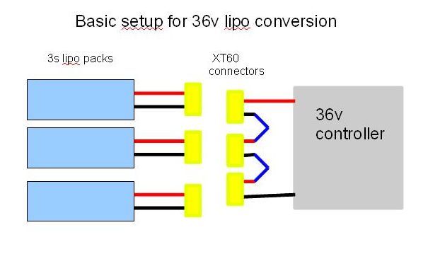

gwhy Posted March 18, 2013 Report Share Posted March 18, 2013 (edited) Here is some pics on how to wire the batterys up to achive the different voltages and capacitys. this diagram is another way to get the 36v ('ish) using 3s lipos. using the 3s setup is more in the real ball park voltage for true 36v operation but this setup can get a bit tricky with re-charging using the 5s and 6s setups the charging and manual BMS becomes a little easier to manage. Just a quick work of warning: always check that any battery is at the same voltage as another battery that you are about to connect it to in parallel, the series connection its not so critical. You don't need to un-parallel the battery's for charging but I would advise also paralleling the balance taps of the parrelleled batterys and balance charge at least 1 out of every 5 recharges at least until you get a feel for how well the cells remain in balance. Edited March 18, 2013 by gwhy Link to comment Share on other sites More sharing options...
8690q Posted March 18, 2013 Report Share Posted March 18, 2013 Excellent ! Thanks for the help and the wee diagram. So 2 6s would give me volts and mah. Will the bike be okay with the fully charged lipos being closer to 50v ? If done the 2 5s way will the power difference be noticeable over the sla batteries ? I'm looking at the Hobbyking site the now and your right about the battery prices, perfect. Link to comment Share on other sites More sharing options...

gwhy Posted March 18, 2013 Report Share Posted March 18, 2013 Excellent ! Thanks for the help and the wee diagram. So 2 6s would give me volts and mah. Will the bike be okay with the fully charged lipos being closer to 50v ? If done the 2 5s way will the power difference be noticeable over the sla batteries ? I'm looking at the Hobbyking site the now and your right about the battery prices, perfect. no 2 x 6s will give you 44.4v ( 48v) which is to much for the 36v oset, the 36v oset may be ok to run on 48v but it will have increased top speed and more power but the motor and controller may not survive for to long as they are not rated for 48v . if using 5s this will give you a off the charger voltage of around 42v so there will be a small increase in power and a small increase in speed over using sla's which will be around 39v off the charger. But dont forget that you will need 4x 5s lipos you will be parrelling 2x 5s then connecting 2 of these packs in series to make up the 36v. if you order lipos from the HK website dont forget to get them from the uk warehouse :-) it can work out a very expensive mistake. Link to comment Share on other sites More sharing options...
