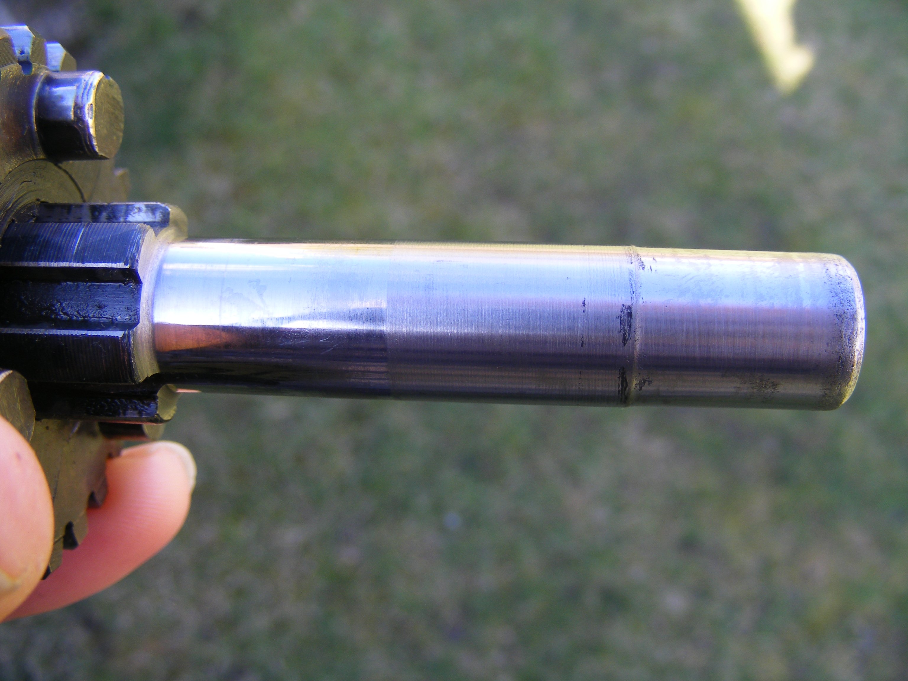

Looks like the copper guide bush is worn out
There are two of these bushes in the sleeve gear - your pic. shows just the outer one. As woody says, you have to dismantle the engine to replace.
You may well  find corresponding wear on the gearbox mainshaft.............
1240028971_Bultaco5spd.gearbox-weartomainshaft-model80.thumb.jpg.2b11e098a519d5e5ab2f7e1ca353b0be.jpg
When you re-assemble fit a felt seal (part #414-052) as mentioned by on it.
Good luck with the repair.

The engine has been split, mainshaft adjusted and new bush custom made.
Since the engine was open, a complete revision had been done.
