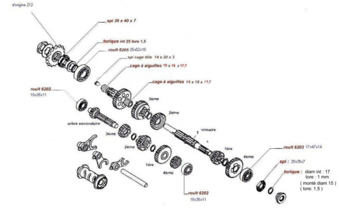

hi all just going back to my oil leak on the front sprocket. ive put new seal on the end of the sprocket shaft cant seem to stop it leaking. ive allso changed the seal and o ring and bush behind the front sprocket. could it be ive not put the o ring on the shaft proper? ive cleaerd the gear shaft breather so im at a lose end please help me.

I have no real clue, may be you mounted the distance bush # 17 wrong?
Here is the assembly order to the 199 model:
# 46 spring clip
# 45 oil seal 14x20x3
# 40 ball bearing
# 17 o-ring
# 21 distance bush
# 43 oil seal 30x40x7
# 29 countershaft sprocket
# 23 sleeve gear fixing washer
# 22 sleeve gear fix
# 46 spring clip
# 40 ball bearing
# 17 o-ring
# 21 distance bush
Motor%252520Bultaco%252520Sherpa%252520199b%252520Br%2525C3%2525A4uer%252520Ausschnitt.jpg

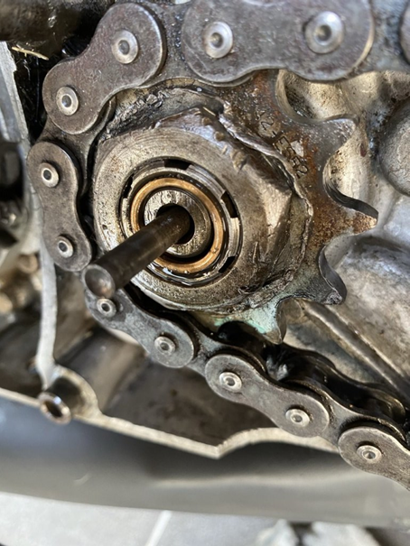

  • 9 years later...
Hi,
my Bultaco Pursang 250 MK5 also have a leak on the front sprocket. Looks like the copper guide bush is worn out. Can I replace this part without having to split the block?
Edited by BPursang_ro
 used to run a felt seal it covered end of shaft ( clutch rod went through it ) to soak the oil up  about 3-4mm thick hope this helps
Thanks for your quick reply.
But if I want to replace the bush, do I have to disassemble everything or is there some trick without spillting the case?
