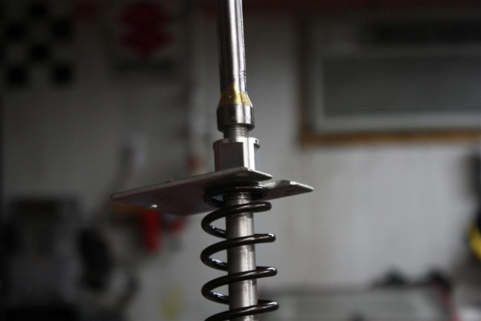

I think you pull the spring down from the top (maybe compress it using strong cable ties) then hold the top nut (the one with the adjuster in) and undo the exposed hex nut under the spring near the top. Is this correct?

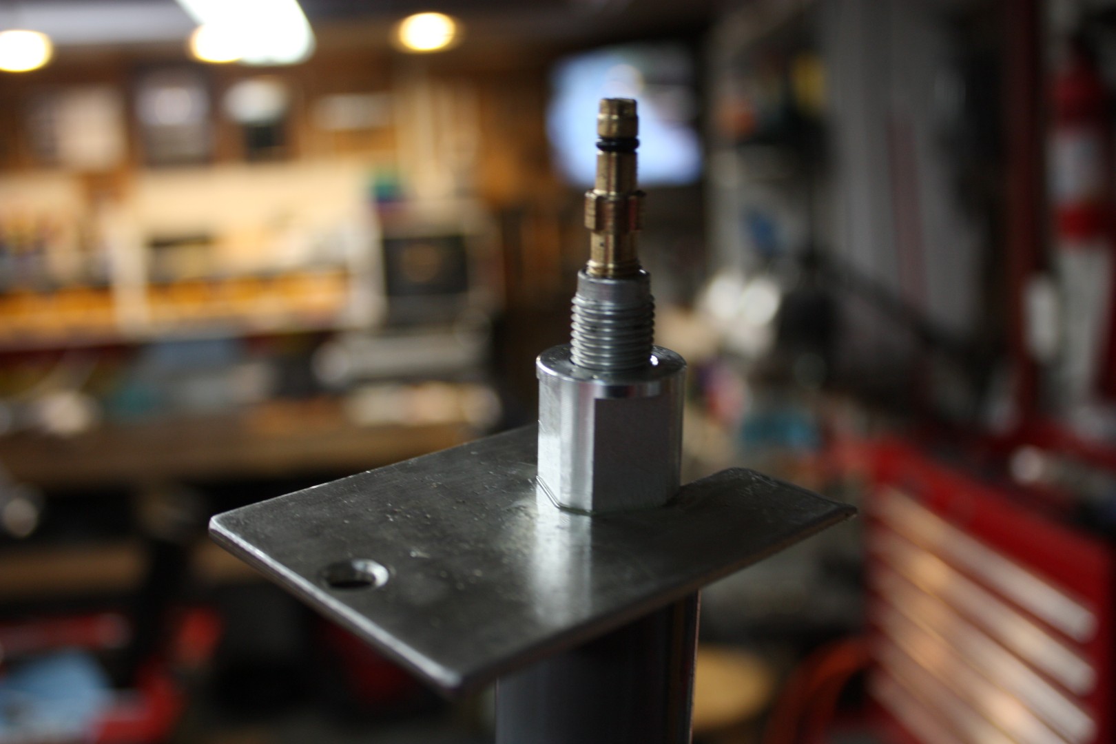

You can make a small plate with a slot in it (the width of the damper rod) to slide under the jam nut when you pull down the spring/spacer. Assemble the fork and leave the upper tube unscrewed from the top cap, tilt the fork over slightly and slowly pour the oil through the spring coils into the lower leg.
Jon
