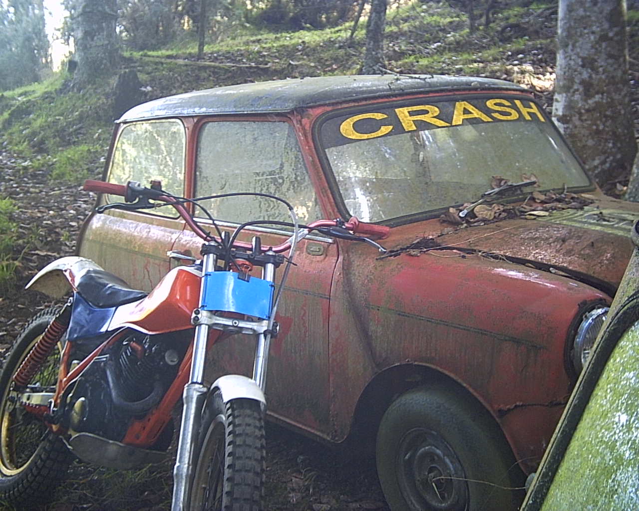

I've ridden a TLR250,and power and gearing problems are solved,a nice bike to ride.The 250 uses different ratios and has a different sprocket spline....I hear talk of a 9 tooth sprocket,is this available for the 200,and if so where? The TLR200 was popular here,and quite a few turn up sometimes,and there is the odd 250 as well,I'll see if I can post an image here,a TLR250,and the one behind is a factory job with alloy tank and seat.

A couple of shots of my TLR200,in trials setting.
PANOMPHAEAN,,That bike of yours looks familiar , have you ever transported it in an odd little french car , or ridden up a dam on an alp !
Oh! Yes, still have the video to prove it:) Who be that? There was an absoluteley stunning TLR250R for sale the other day. 1986 with 1,200KM on the clock for
Nice bike but the acerbis handguards dont look to good on it ;)
