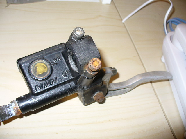

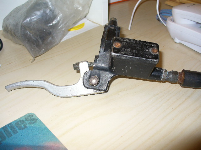

November 19, 201214 yr Can anyone identify this master cylinder, I would like to get a new blade for it. Cast into the body Nisin LWR & 2T Thanks Ross
November 19, 201214 yr Looks like a fairly standard master cylinder from a late '80's early '90's mx or enduro bike. Any Honda/Suzuki/Yamaha/Kawasaki dealer should have one.
November 19, 201214 yr Looks exactly like the Honda cr125 1984 master cylinder I installed on my Montesa 315, when I smashed the stock one. Incedently works much better than the stock ajp one.
November 19, 201214 yr Author Thanks tlmark, it can only be better than the Brembo one on at the moment.
November 19, 201214 yr Looks exactly like the Honda cr125 1984 master cylinder..................... Confirmed
