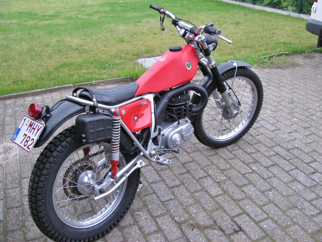

Well, here she is. Ready to race on friday evening (There are still a few things on my wish list like the front and rear (leak) suspension, a luminium sump guard, steel brake liners...)

very nice like the black gards. do the light work?
Thanks and yes, al new electrics
Very sweet, :popcorn: I' am too in the process of electrical wiring, where are the switches?

Thanks pschrauber,
There's a light switch on the handle bar just left of the crossbar and the stoplight switch is just above the brake pedal.
