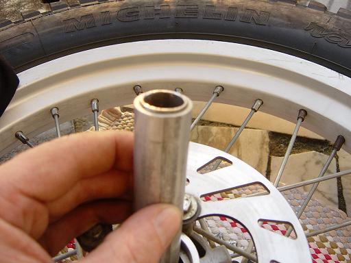

Unlike most road bikes (except Ducati I believe)..the spacer between the two wheel bearings (on the rear wheel this is...NOT the front)...does not have any play in it.
Meaning it is tight up against the bearings, so it is very difficult to get BEHIND the bearings with a punch, to knock them out.
The first time I did mine, I ended up destroying one bearing..(cutting etc.) untill it came out, and then obviously you can get behind the other one to knock it out.
SOmeone last time suggested that whilst you do it, cut a little channel/gap/V, in the spacer, so that the next time, you do it, you CAN get behind the bearing.

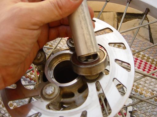

Hopefully, on this pic, you can see where the spacer, has a step in it, which fits snugly up into/against the bearing........THIS is why its so difficult to get BEHIND the bearing to tap it out.
