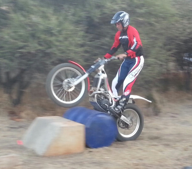

Hi guys
I can make it over a single free standing drum but im not sure if the technique is right. Im trying the double blip thing, first one puts front tire on drum, second one I throw weight forward to pull back onto drum. I do try to bounce the rear wheel up just befor the second blip to help. Have I got the basics right? I am riding the bash plate over the drum and it doesnt feel graceful, more like just powering the bike over.
Keep in mind im brand new to trials and have only been riding for about a month (2weeks of that has been waiting for torn ligaments in the ankle to heel).

Hi, first blip should put the front Tyre into the drum making the forks compress. Then as soon as they compress the second blip comes in pushing the front into the air with the baseplate completely clearing the drum. These two blips happen really quickly and close together. Remember to bend at the knees and stay loose on the bike.
Hope this helps.
As Mr Wobble said
Drive the front wheel into the drum. Rule of thumb drive the front wheel 75% up the face of the obstacle.
This will load the front end and force the skid plate and bike upwards.
Placing or just skimming the front wheel on the top of the barrel will do nothing for you but driving the skid pan into the obstacle.
In the picture you seem to be keeping pressure on the back wheel and the back wheel is flat on the ground. That says your are not unloading the rear suspension or bending your legs/knees.

For small-ish stuff like that, I like to raise the front wheel a bit higher and let it drop almost on top of the obstacle, this compresses both ends and the 2nd blip carries me over without hitting the plate (mostly...well...sometimes).
I have to be moving a bit slower than with the method of driving the wheel into the obstacle, but I find it smoother when I get it right.

Might try a single blip, so just lift the front a bit before the obsticle, let it bounce off the log at the halfway point which will give you the height to clear the plate. Anticipate the rear wheel strike and unload with yoyr knees as the rear hits the log so the rear can come up under as you shut the throttle.
Hopefully you will have enough revs and momentum to carry over if done right.

I think it's much easier to divide the barrel in half with an imaginary horizontal line, then divide the top half with another line.
You might even consider wearing goggles and scribing a line across the lense that you could line up with the right spot on the obstacle.
Maybe tape a laser pointer to the side of your helmet.
It's really quite simple...

On stuff like this size I sometimes just do what they call a roll up in bicycle terms
You pretty much just hit it with the front wheel at the 3/4 point, it pops the front end high and the back just kicks up and on top
Doesn't work on undercut stuff very well but on low logs etc its good

Blip throttle, front tire comes up. Something that size is immaterial if it tire hits face or sits on top. The key is push down on pegs to compress rear suspension then as you give the second blip "jump" up and the rear will "bounce" on top of log.
May not be pretty or smooth or "greatest" technique but gets the job done.

Mokwepa, try to heed these guys' advice about "riding loose", and keeping your knees bent slightly more than they are in the photo. Keeping my legs too straight./knees not bent is a problem I continually fight myself. It makes a huge difference in your riding.......
Sometimes, on obstacles like you have in the picture, if I have enough room, I approach them with my knees flexed pretty good. I'll pick the front end up several feet before I get to the obstacle, and drop it downwards on the upper 1/3 or 3/4 (You pick your own fraction!) of the obstacle. As the front end rebounds from this, blip the throttle a small bit, and jump up as hard as you can; you have to put some effort into it. The unloading of the rear suspension as you blip your throttle/straighten your knees/jump up will usually pick the back end up high enough to help roll over the obstacle. Timing is pretty much everything in this "Zap" type of obstacle clearing, but even old Dorks like myself can manage to learn this. Sometimes......

yep like Neutron says (I will paraphrase) most of it is in the legs and timing.
being "loose" and comfortable on the bike makes things much better.
