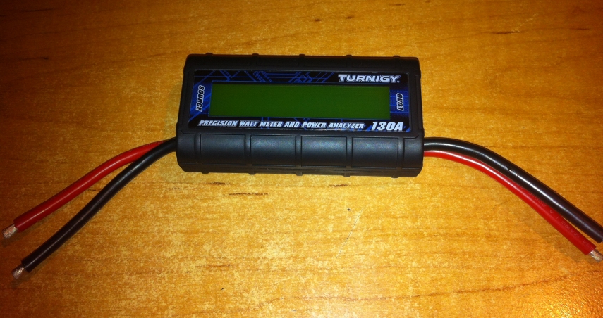

The only real way to find out what is going on is you need to buy yourself a watt meter, this will tell you exactly how many ah you are putting into the batterys when you are charging them and will also be able to give you the information about each bike i.e max current pulled , ah pulled, running voltage,min running voltage and max watts pulled this information will help find out what is going on . You can get a watt meter from Hobbyking http://www.hobbyking.com/hobbyking/store/__10080__Turnigy_130A_Watt_Meter_and_Power_Analyzer.html

If you are in the uk then I would get one from giantshark.. Hobbyking do membership but try to get the items you order from the warehouse nearest where you are ( this can save a fair bit on postage and time..) You only need 1 meter if plugs are fitted the meter can be transferred from bike to bike very easy and also be used on your charger..

Just thinking about how many plugs/sockets you will need to be able to switch the meter over to 2 bikes and also use it on the charger to get the actual Ah needed to recharge battery to full .. I think it works out 4 pairs at least.. a pair on the meter a pair on each bike and a pair on the charger leads..
