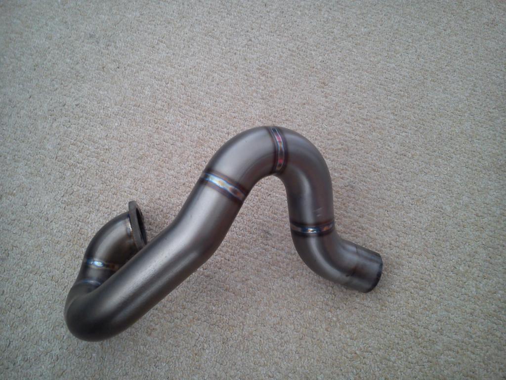

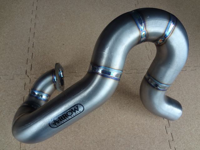

Hi,
First pic is the old shape pipe, If you look at the top bend you can see it is different to the new one, This is so it clears the engine mounting, Although it is very close to the small screw that holds the tank panel on my bike, Not sure what it's like on the 2013 bike.
When I swapped mine to the newer bend I did find that it increased performance slightly on the bottom end.
