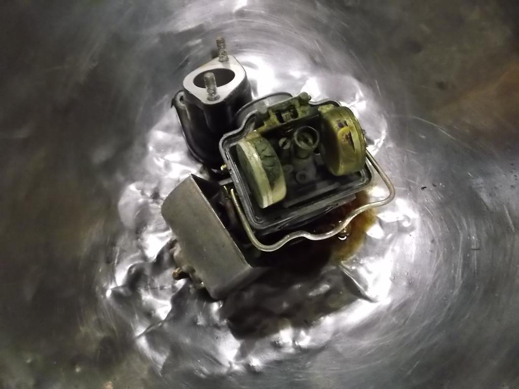

Well a little bit worse than I thought ! Worse carb I've ever taken off a bike in about 40 years... Bike obviously sat outside with petcock on for quite a period of time .The following foto is after getting the bowl off and 2 cans of carb spray ! GREEN slime/grunge to the point the bowl was part of the body ...post-1232-0-45008000-1379880938_thumb.jpg But after putting the carb in a bath to soak before further disassmbly , I shot some carb cleaner in the intake and gave her a kick ....
She fired right off and ran a few seconds , so it's worth the effort ! Gotta LOVE Honda's !

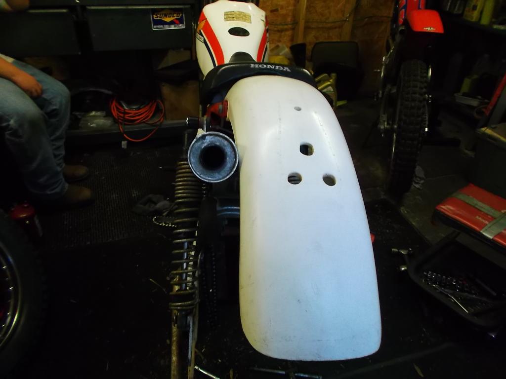

And to make things even odder ! The front fender on the bike is a nice O.E. Fantic fender ! Logo and all !!!!!!!!!!!!!!!
It is just trying to fit in with the rest of the steeds in the stable! :D

I'll wait till the new float and valve get here , Carb cleaned up pretty good , just took a little time . I put the stock Section pegs on it for a little bigger peg for free ... It's geared 10/44 right now , so that will be a good basis for me to judge how I'll set it up for my son . He Can't wait to ride it !!! :) Still got to adjust/check the valves and change the oil after it fires on it's own . and gets a little de-carbonizing of the top end ...

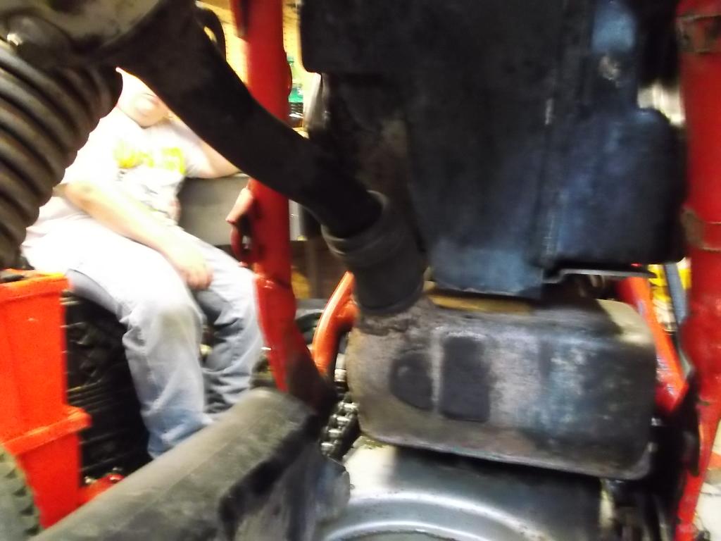

Valves adjusted and double checked etc . (damn honda frame in the way !) Timing chain quieted right down with a minor adjust... Even starts better with clean oil !!!! First test fit of exhaust repair/ (cheap customizing!!!) as the rear silencer is not worth the effort of getting the pieces out of ... A little welding work from my neighbor that builds custom headers you wouldn't want to pay for and all will work for now ! and I don't even know what or where the silencer came from/off but it was in the shop !!!....

And yes it's held in place with a zip tye in the photo , but a little cutting / welding / drilling and it will look and work better than OE ... I rode it , off idle response is WAY !!!! better :):)
And Yes, it cleared the tire but not the shock under full compression , but we will shorten the body of the silencer and lengthen the inlet pipe to rectify that .... FREE is so cool on a $ cheap build ...
