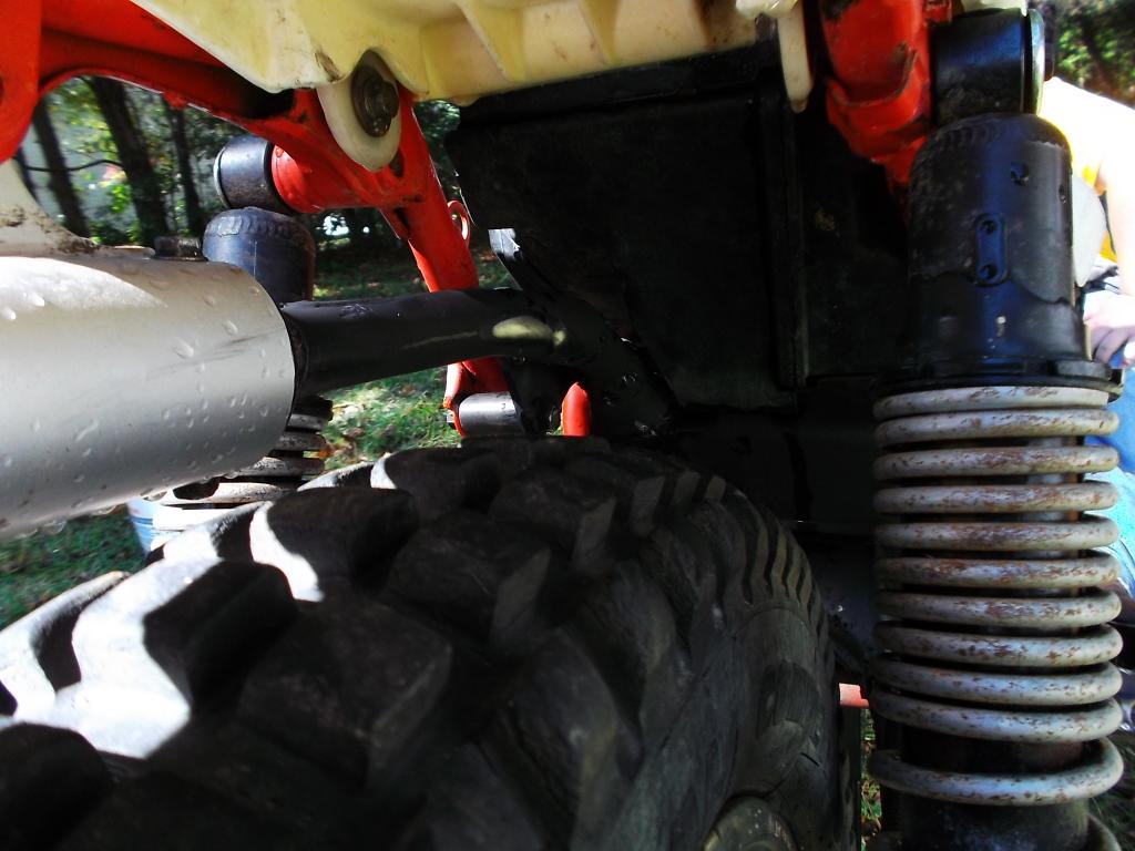

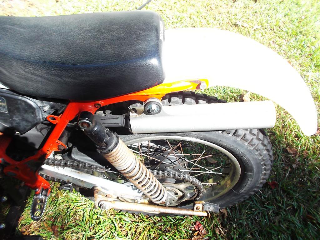

Exhaust on ,Slight rub with me on and preload @ softest setting, no worries...(Free silencer and 15 min's of my neighbors welding expertise ), carb rebuilt and tweeked , old bars and grips on , ungratefull kid polishing wheels....Bike works OK...., motor makes a few noises I'm not fond of, Carb works fine for him, I'd want a pumper . Has 10 - 44 sprockets right now , will change that to 12 - 58 asap , just to slow it down a little and teach young son THROTTLE CONTROL !!! Still loving old honda's :) Got to do laundry and groceries right now , then load up for a event in NC. Leave at about 5:30 am .
