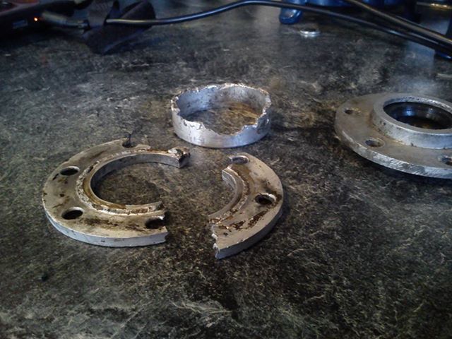

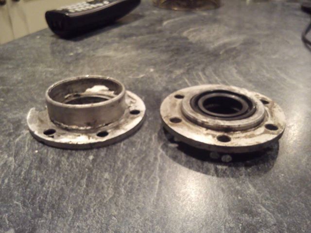

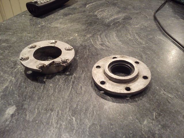

Can anyone help me source a new seal holder? as you can see this one is totally shot!! I've never seen one with such a deep insert.
Cheers guyspost-19469-0-12721500-1390649836_thumb.jpgpost-19469-0-73450300-1390649846_thumb.jpgpost-19469-0-95124800-1390649854_thumb.jpg
They have the deep insert for the engines that have only a single main bearing on the clutch side

I don't know. Not sure if the crank is suitable for 2 bearings so I can't give you a definitive answer. However, I can't see any obvious reason why a later holder without the deeper insert couldn't be used. But I could be missing the obvious...
By the way, you only use a gasket or an O ring, depending on which holder you have. Not both together.

Cheers woody, i was wondering whether to use a different holder. I realised about just using the o ring, or the gasket.
Thing is if i use another holder, will it affect using the wear sleeve, or do they all have the wear sleeve?

A company called Motos del Abuelo do various seal housings, http://www.motosdelabuelo.com/
Click on the Bultaco parts catalogue and they are on page 22. I emailed them last week with a drawing of mine which I think is the same as yours, 15.5mm deep from gasket face to inside face. The price is 22 euros but the P&P is a bit steep at 30 euros.
Like I said in an earlier post, if I can't get hold of a decent used one I'm going to machine one so if you're stuck give me a shout and I'll make two but I wont be able to get on it for a couple of weeks.
