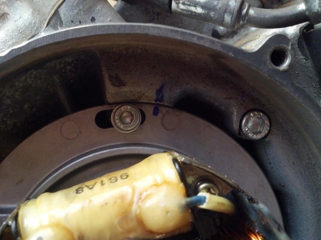

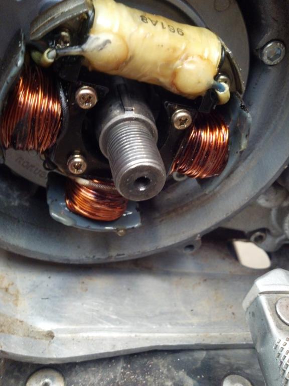

I removed the flywheel and checked to see if it had spun on the shaft--nope, and Woodruff key is in place. Stator is on its marks and looks fine.
I checked the rest of the ignition stuff as best I could, and replaced the spark plug. The coil resistance checks out, and the stator puts out about 35V AC while kicking it over.

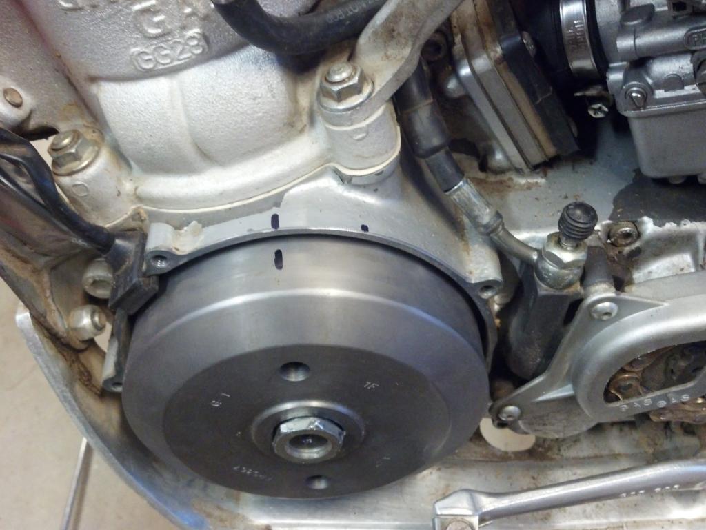

I've tried to attach a photo. The longer mark on the case is TDC , as best as I could find it using a screwdriver through the plug hole. The smaller mark, well before TDC, is where the crank mark hits when sparking. Using a protractor I find it to be ~23 deg BTDC.
I can't seem to find the spec for it, but that seems like a lot... Should I adjust the stator in its slots to bring it closer to TDC?

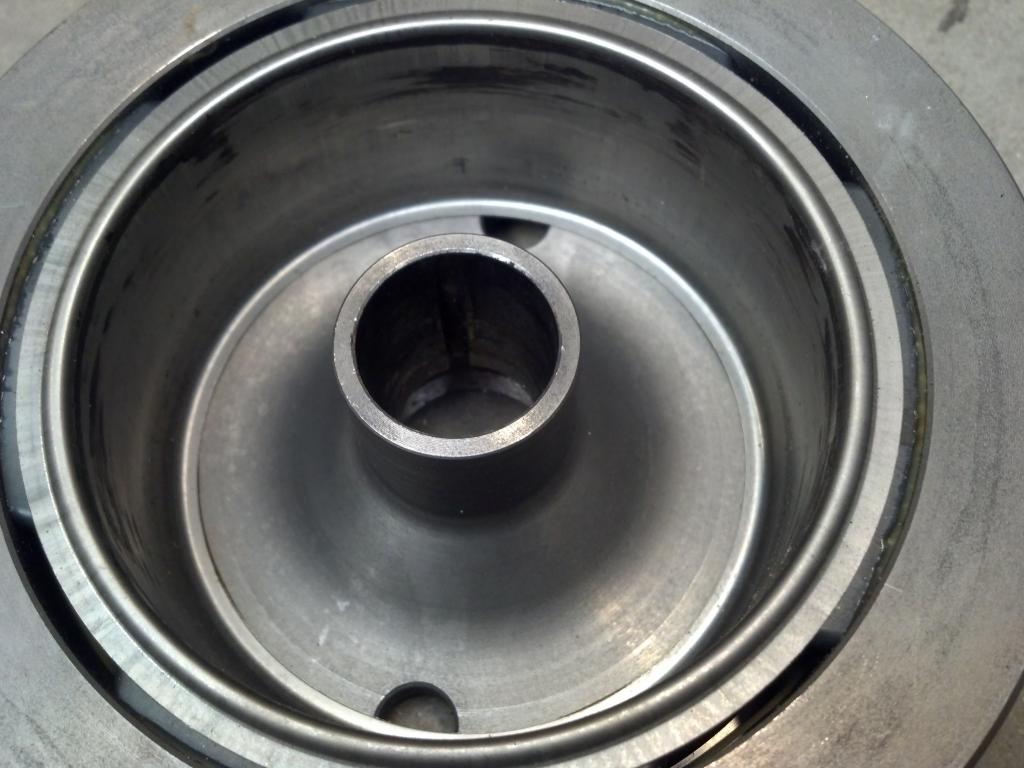

Get a flywheel puller and use it. inspect for sheared woodruff key. I would order both at the same time if I were you!
Had the same problem, turned put to be a sheared Woodruff key. Thirty pence later sorted. I now always carry a spare in the tool box.
Thanks for the replies guys. In my first post I wrote: "I removed the flywheel and checked to see if it had spun on the shaft--nope, and the Woodruff key is in place. Stator is on its marks and looks fine."

I employed the dial indicator method of TDC location and determined that my original mark was a bit off. Using my more accurately determined mark I find the plug firing point to be more like 20 degrees BTDC. Turning the engine with a drill results in a good looking, blue spark every time. I also cleaned the grounds and made sure everything was tight.

Sometimes woodruff keys can shear or deform and the fault may not be easily visible. Its a cheap part to replace if you are unsure. If its hard to find one, I have made homemade ones out of a metal washer or even a coin.
I doubt it is a fuel problem. It really sounds like a spark timing issue. Remember, there is no mechanical advance mechanism, the advance is done by the black box. I suspect the box has failed and gone to maximum advance. I have seen offset woodruff keys that would have the effect of retarding the spark. It might be smart to get one and try it.

Whilst spinning the crank with my drill I noticed the timing does change. At lower RPMs it was less advanced, perhaps 10deg, then moved up to the 20deg mark and stayed there. The blue marks were on it when I acquired it, and as you can see it's on them. Should I just move the stator to retard it and see what happens?

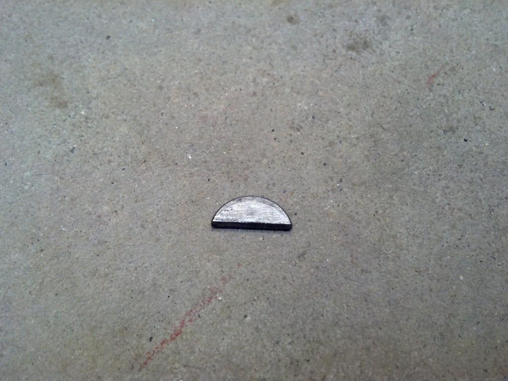

Let's put the woodruff key question to bed:
