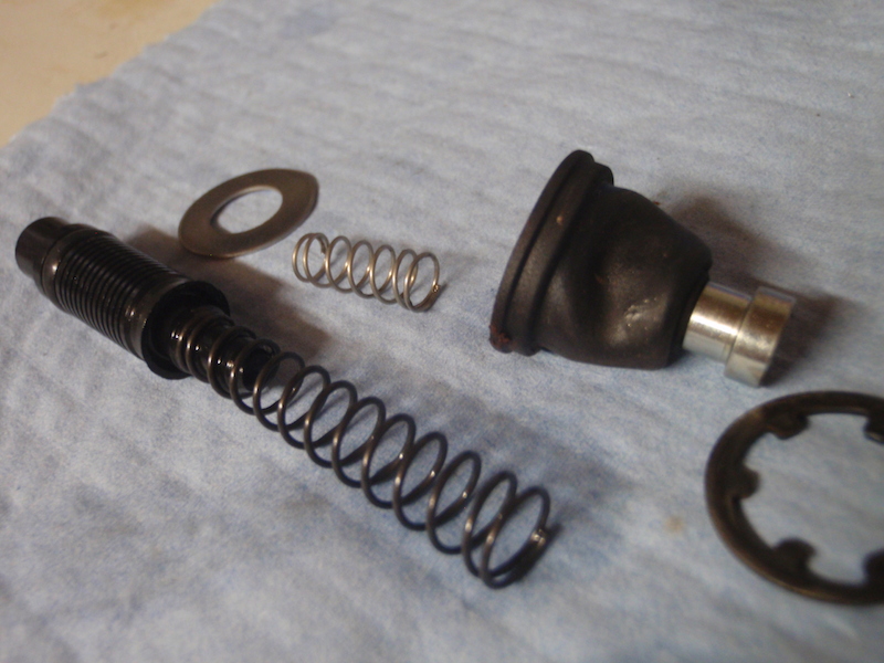

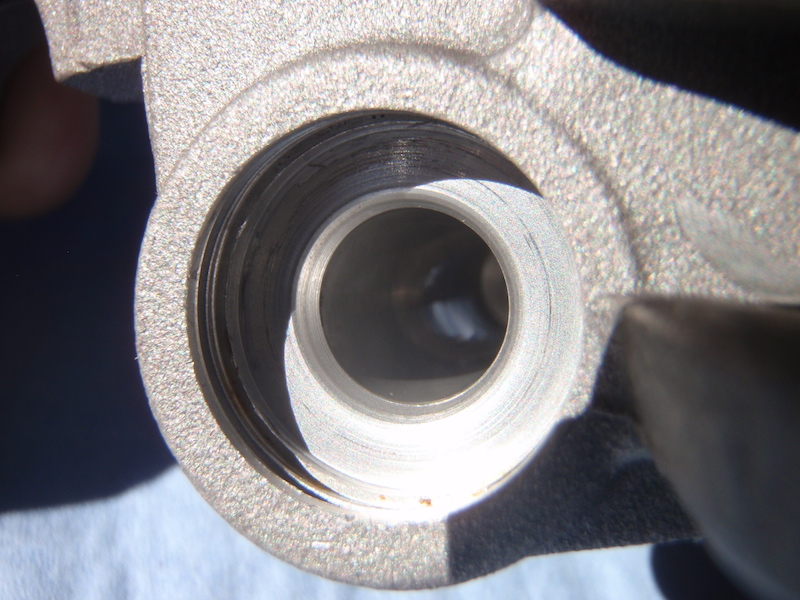

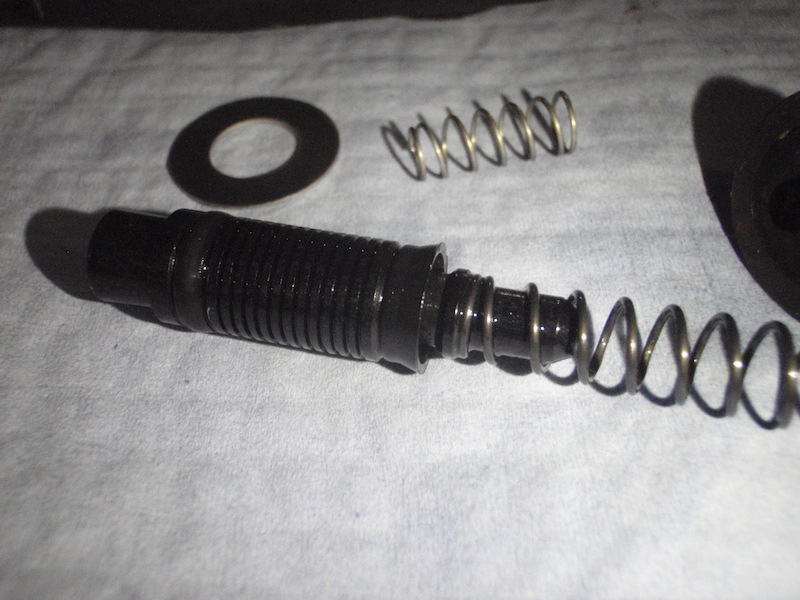

Ok! Stripped it down and it looks pretty pristine in the bore and inside reservoir. Spring looks and feels great... including the small rod one.
All I can put it down to was the outer "O" ring a bit grippy because it seemed dry of a smear of brake fluid???
I've assembled back together and smeared just a touch of teflon grease on the outer "O" ring. This seemed to cure the issue as it returns beautifully now.
All bled up with good hard lever feel. Lifted front wheel up by milk crate and spun wheel and applied brakes 25 plus times... didn't stick once and wheel free wheels beautifully.
There was a slight area of corrosion on the "C" clip that holds the piston in. Brake fluid on the bare steel I'd say... the "C" clip groove was corrosion free.
There was a small burr inside and out side, from stamping it out, on the washer style plate that sits under the "C" clip. I used a 1000 grit stone and removed it.... for no there reason than it was out.
Time will tell if permanently cured, see how it goes next outing?
