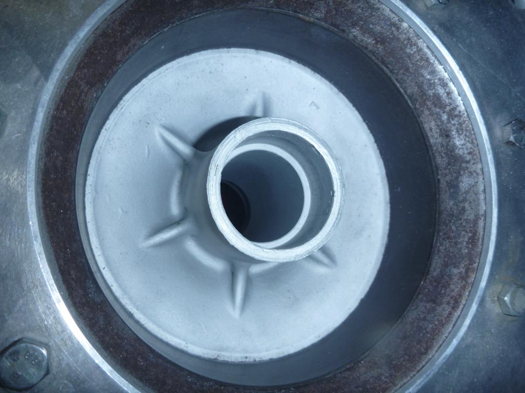

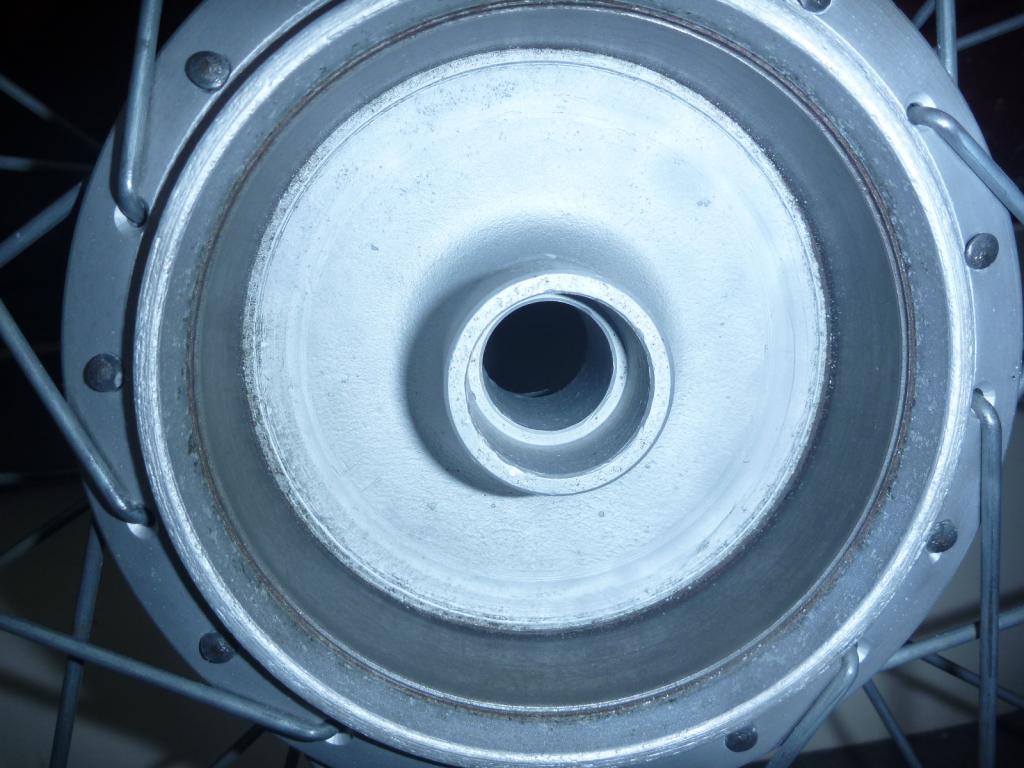

would someone be kind enough to enlighten me as to the state of my hubs please? should they be shiny chrome or have they been steel lined? before the bike was stripped down the brakes did work but since this is my first bike I've no benchmark to compare.........
cheers
D
they should be both shinny chrome and look ok on the photos. even if there's slight pitting should be ok it's only when there badly pitted that they need relining. make sure you heat the hubs up with warm Air or heat gun before putting the wheel bearings in.
