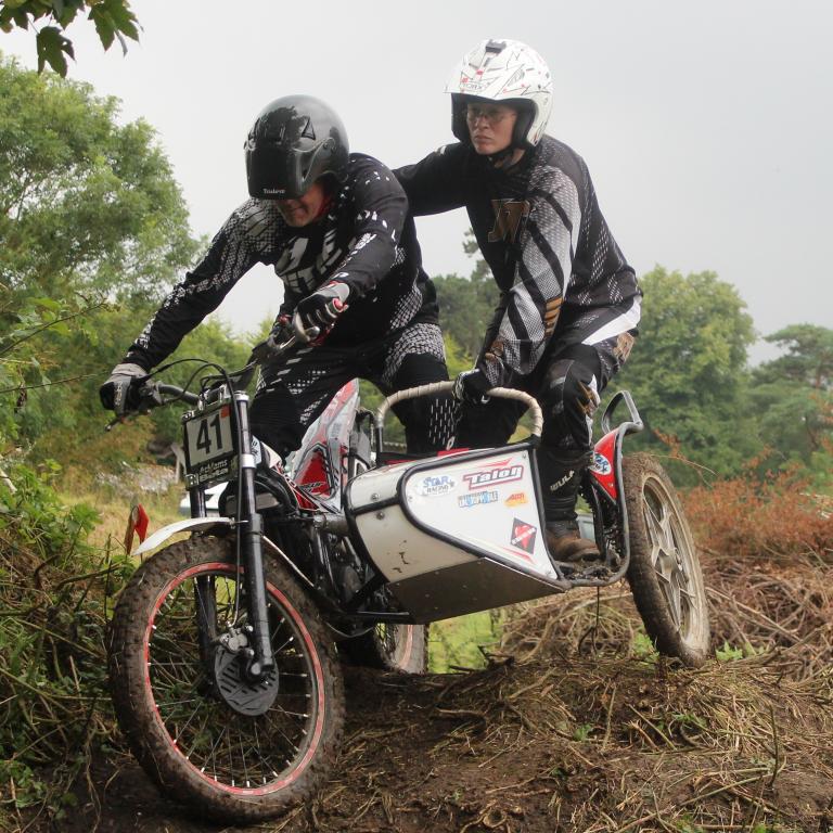

October 2, 201412 yr I have a 2003 rev3 270 spare and would like to add a chair to it any advice welcome. Is it suitable and if so what chair and suggested price? Thanks
October 2, 201412 yr i think you would pay £300 /£400 for a used sidecar ,i put one on an evo and it's been a laugh ,not the easiest of things to ride and you will need a spring on the rear shock as well
October 2, 201412 yr Spotted this on e bay don't know if any good for you.http://www.ebay.co.uk/itm/Trials-Side-Car-/181538559133?pt=UK_Motorcycle_Parts&hash=item2a448a949d Edited October 2, 201412 yr by bilks
October 2, 201412 yr A 270 would be fine pulling a chair. I've had one on a 250 Evo and now have it on a 300. The 300 is a much smother & stronger engine, but the 250 was fine. You will need to fabricate a sub- frame for the front & rear of the bike. Front to spread the load and the rear one for the passenger to hold/use for putting their weight on.
October 3, 201412 yr Author Thanks for the advice Just missed the ebay one, will continue to look for a chair
