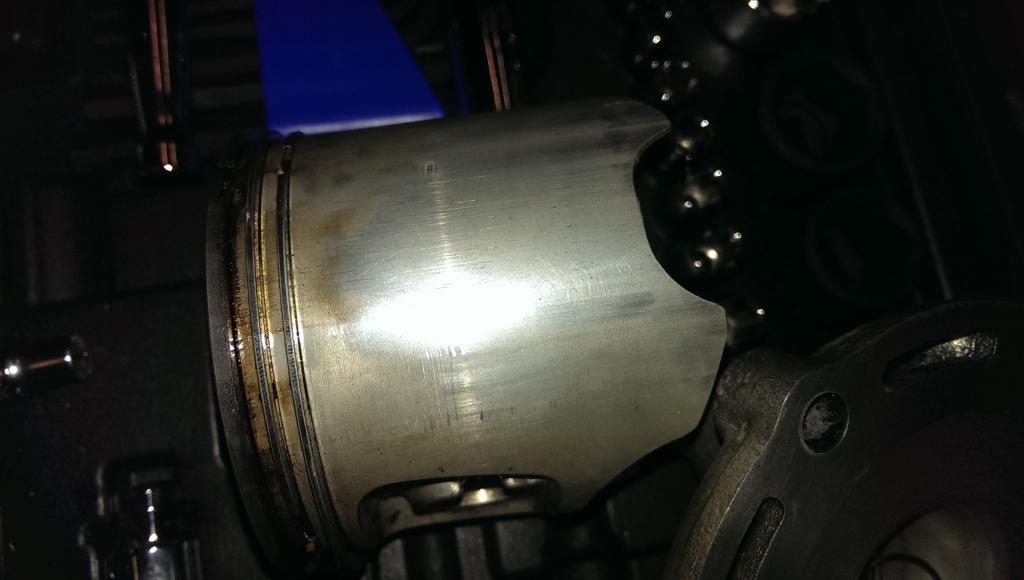

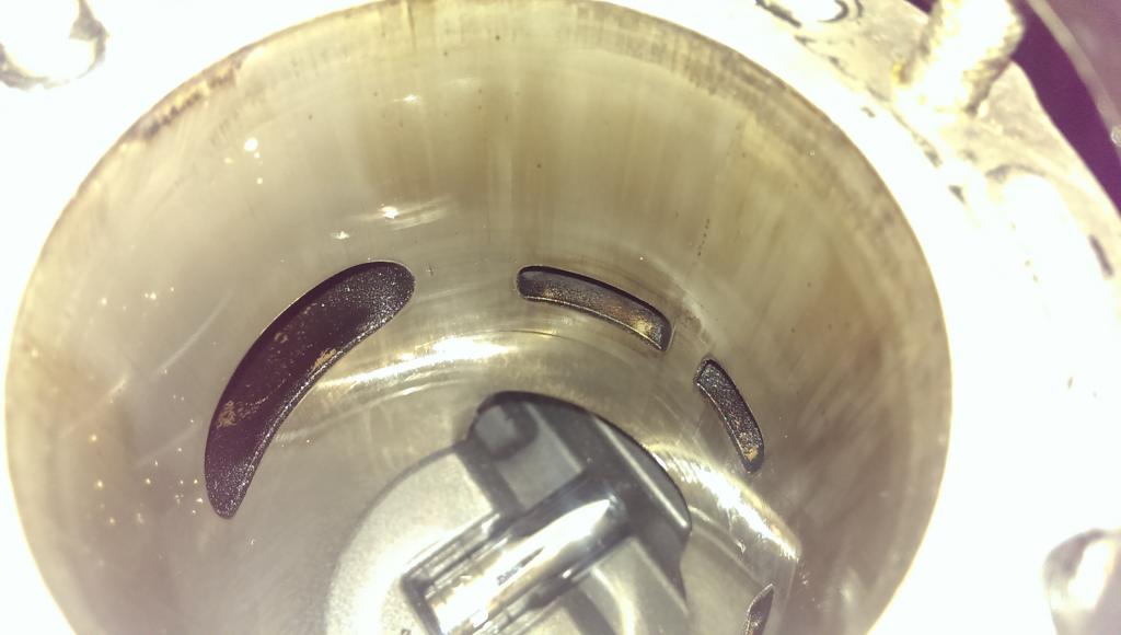

So I whipped the head and barrel off today. All looks very good. Definitely play in the little end and the piston noticeably rocked in the barrel (at TDC).
Now there is no letter on the piston for A, B or C but the barrel says A so should I put a B piston in? The piston lining has a very very slight lip at thebbottom and top.
I would like to put the B piston in if it will improve sound and longevity.

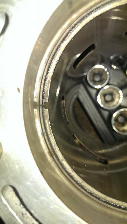

Here is a picture of the piston ring gap.
Obviously I am worried if I go up a size in the piston I could break a ring and wreck everything...
Here is a picture of the piston.
And the barrel

Thanks, I really can't afford a barrel as well though. Plus it looks like mine has been pretty well looked after and I don't see any wear on the barrel.
I have had a look around on other forums and they are saying that the difference between A B and C pistons is very small. My thinking is that any wear on the barrel will be compensated by a very slightly larger piston. On the other hand, I don't want to go ahead and cause any damage.
I may just end up getting an A piston and given that the main source of the noise was little end wear I hope it will cure the noise.
Cheers for the reply :)
Right, just been on the phone to Sandifords who sell the piston kit, and looks like the only option is an "A" piston and putting any larger piston in the barell is a big no no.
