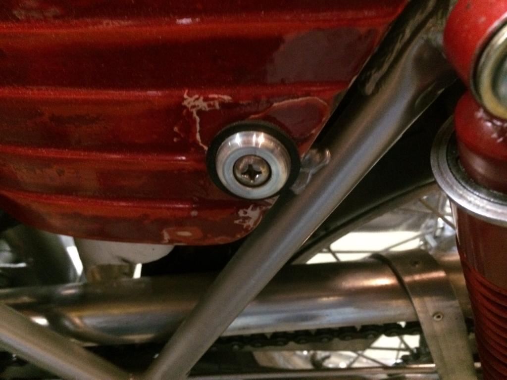

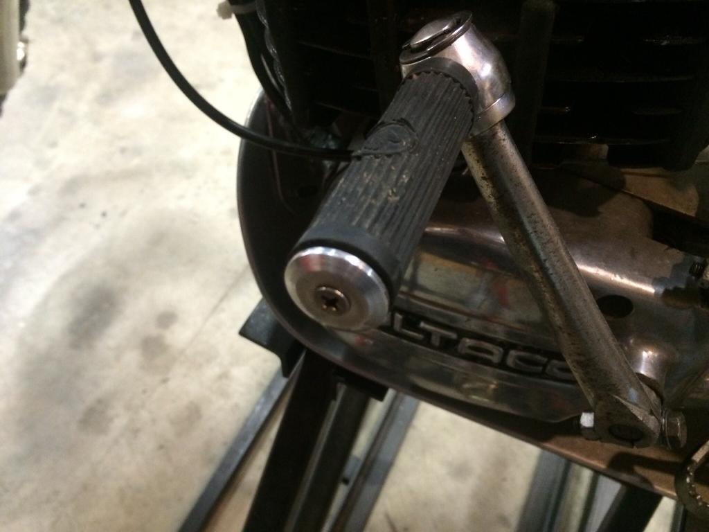

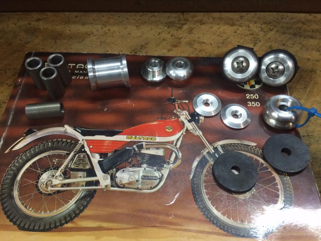

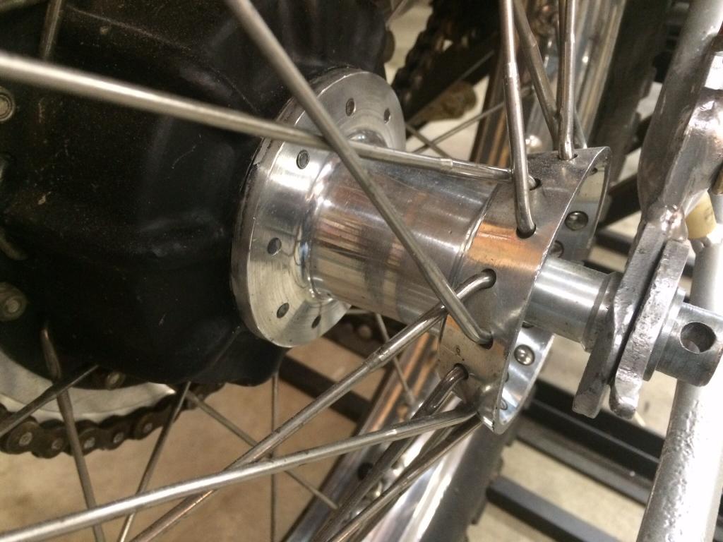

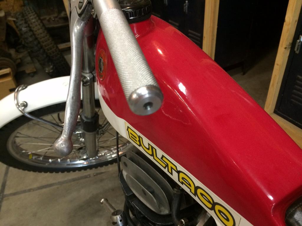

Added a few shiny bits that Larry, lbhbul, turned for me on the lathe. Bar ends to help keep your grips from tearing when you drop the bike. Kick start rubber retainer. Wheel spacer. Tank mount rubber and washer. Foot peg bushings.
Hello saw miller and scot taco good thread to the kick start rubber that's a great idea iv'e tryed  a few things to keep that rubber on and as not worked. however on my 199B kick start it as a flange on the end to stop the rubber coming off but your idea is good. scot the Air box is looking good i know what you mean about drilling holes in the Air box i was the same but done a few now i put a small washer on both sides. cheers bondy.

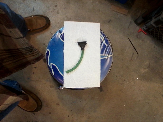

post-14329-0-39574800-1429819198_thumb.jpgJust messing about in the shop and remembered a thing or two
that might be of interest to the fellows.

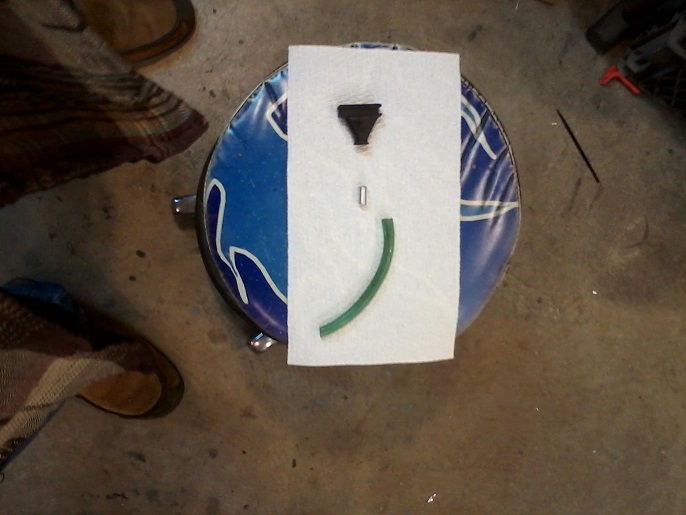

Ignition waterproofing perhaps.
One way is to use the easily obtainable OEM rubber gizmo and RTV sealer,
a piece 1/4 copper tube and fuel line to house the hot & ground.
The other is custom and I sent 5 to 1974 SSDT in hopes they would get back
to the factory, never heard from again.
Have a nice day
Larry

Saw Miller,Larry does darn nice work.Those are the kind of little details that really make a bike.I will have to post a pic of my kickstart rubber tomorrow.It,s functional but not near as nice.

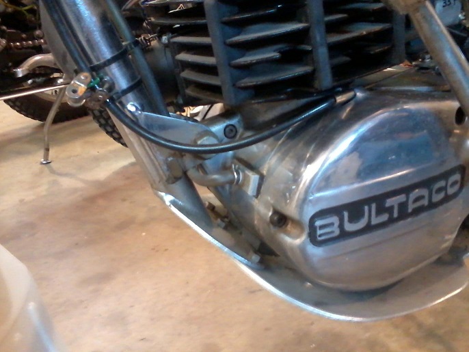

bondy,I hope you post pics of that bike in red as it,s coming along and when finished.Your bikes always end up looking superb.Where did you get that bashplate? I like the way it protects the mag cover.
Larry,I,m going to get after the ignition wire cover this weekend.Thanks for the idea.

Hello scot yes ill keep you all updated with the bike as it comes along. the bash plate is from spain a place called todotrials look it up. i think there around 67 euros iv'e had a few on my bikes but the bike am building as a standard bash plate. cheers bondy, Larry good idea on the ignition gizmo i just sealed my 199B 1 with silicon. but on the next bike it will have electric ignition single thin wire so i will use some tubing to protect it. nice job scot on the steering stops i did my own on last bike had to make them abit longer as the fork tubes was catching the nice new ally tank about 2m
