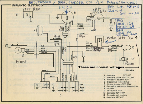

As Furse Said , Check The resistance and check the trigger too , The Dansi ign. is much stouter than the Motoplat used in the early 240's  , Like he said , late model CDI coil  and go from there , The primary coils usually are good or bad/open not much in between , if it loses spark when hot then go for the rewind ...
These should get you started , all the fantics are about the same ...
Have fun , I know you love the bike or you wouldn't of bought her back !
Glenn ,
The one you have to download is a colored schematic ... :)
