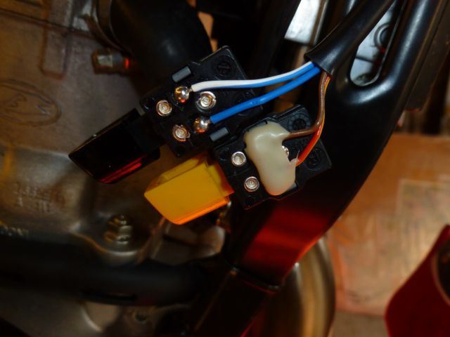

Hi Steve,
You will see from the attached photo that the map switch has 2 wires, brown and yellow/red, the terminals connections are covered with some resin.
The map switch is wired so that the down position is the "hard" dry condition setting, and up is the "soft" wet setting.
From previously checking the switch operation with a multimeter, the down position has the switch closed - hard setting, and the up is open -soft setting. However if you check the unused contacts above where the wires are attached, the switch works the opposite way round.
So if you want the soft setting, make sure the wire ends have no copper protruding, insulate each wire end with heat shrink then shrink them together and secure out of the way against the frame.
If you want the hard setting, solder the wire ends together, fit heat shrink and secure.

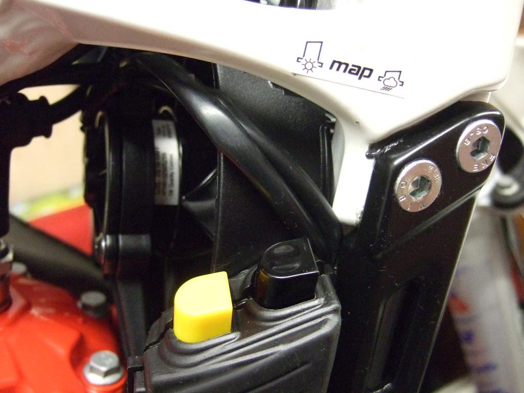

Unfortunately the little sticker on the frame of 2015 bikes shows operation the wrong way round (compared to all the previous EVOs) although it shows the conventional way in the handbook on page 21
The blue and blue/white are for the lights, so insulate the ends of each wire to keep them open circuit and secured them..
Hope this helps

The sticker says button up for full boost. The manual says down.  BillyT says open circuit for full boost. Overdale says wires connected. What's Steve to do?  Hopefully the real life difference in performance is enough to feel so testing can confirm.
I rode my 2015 Evo 2t for the first time. I tried to tell the difference between the 2 maps. Not a huge difference. I felt that it ran better with the button down. With the button up, engine had a raspy sound and rough spot off idle. I couldn't tell any difference up top. So I think button down is full power mode.

Factory 2015 setup, so I'm pressing the Right Hand button thinking that's the map, cos the manual also says it's the R.H one, but didn't notice any difference only to realise via these post's it should be the yellow one!
It's even different to a standard 15 evo!
