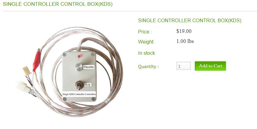

Whats the single control box for in Kelly controller webshop? (see pic)
I only need Kelly RS232 Converter and Cable and Standard USB to RS232 for programming?

My boy is 15 kg, so pretty heavy. :D I did not measure amps with stock controller at all. But I think Kelly is pushing fine, I see clear difference on full throttle starts between 40,45,50 and 55 amps.
-Yep
