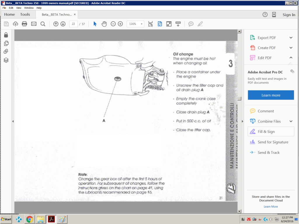

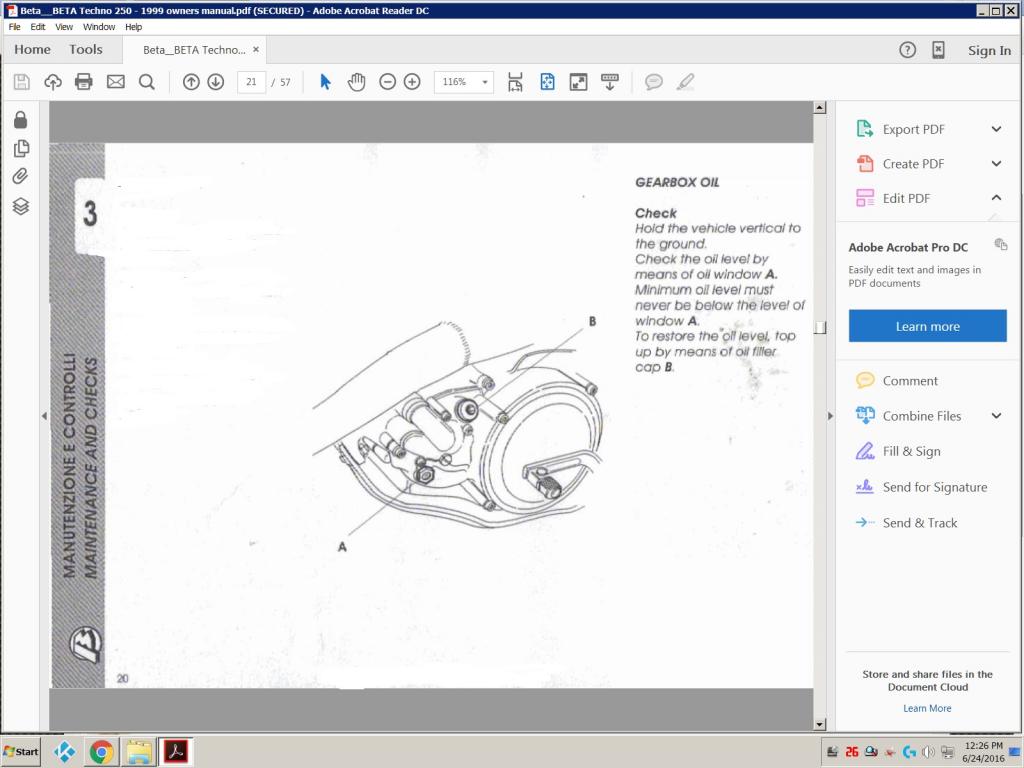

June 23, 201610 yr Hi all, my first trials bike turned up today (1999 Beta Techno),mad bikes all my life but my trials experience is limited to jumping on my mates gas gas jtr at work and promptly twisting the throttle wide open with the inevitable result...... Bike came from Yorkshire and jeez I could have done with a friendly face around to show me how to start it but I got there in the end my st be 30 yrs since I kick started a bike! The clutch stick from cold is savage and I read with interest the fix in the sticky, only prob is the have no idea where to drain or fill the clutch from!! I am sure it will come to me, I have seen the parts manuals on sites but not an owner manual? Trials central looks like a great place, despite the clutch I am very happy with the techno, ideal starter bike!!

June 24, 201610 yr You can get the user manual for your bike here.just type the code and should be good to go.enjoy http://www.carlsalter.com/download.asp?p=271
June 24, 201610 yr Author Epic, cheers Bilks that makes everything clear now! Thank you very much I appreciate your help.
