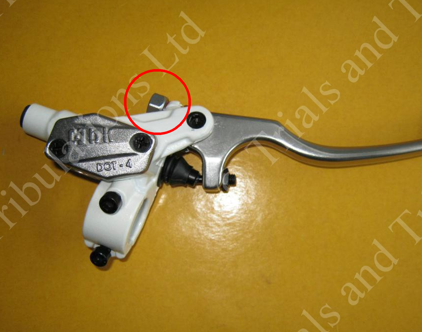

Hey all,
The reach/brake switch holder on my Braktec front brake levers has started to back itself out, does anyone know what the goop is they put in there to freeze the bolt in place. I've been told it's not loctite, it seems to be a plastic/rubber substance. It's only to last me for a single trial on the weekend, after that I'll be buying a proper set of adjusters.
A dab of the blue (not red) loctite should work well and still let you remove it when your done. The blue is quite good and still workable after dry without striping things.
