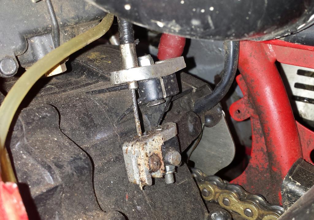

October 2, 201610 yr Here's the home made lightener. Excuse the dirt from today's trial. You can see the top piece has a slight bend to help the cable stay true with the longer arm. You could easily make the top piece and it would work with your extended arm. The bolt is countersunk to avoid contact with the arm.

October 3, 201610 yr Author Thanks for the pics , very helpful , good idea to put slight bend on cable retaining arm , going to copy that .
October 3, 201610 yr An arm that has been extended by welding in 2cm is better than a bolt on job like mine. As you can see it the bulky shape can restrict movement.
