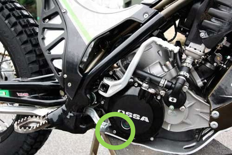

November 29, 20169 yr When changing the oil, drain from both the main plug that has been mentioned above but also from the clutch case drain too. It is the lowest bolt holding the clutch casing on, just forward and below the rear brake pedal. Circled on attached photo. Draining from left hand side doesn't quite get all the oil out. Make sure bike is warm too, helps get as much out as possible.
November 29, 20169 yr Author Warm, left and right, check! Thanks! Found that the oil came from the breather hose. It ends just above the chain and frame. What is the correct length? Just hangin at skidplate? And where to find this dimension of tube??? Windwiper tube?
