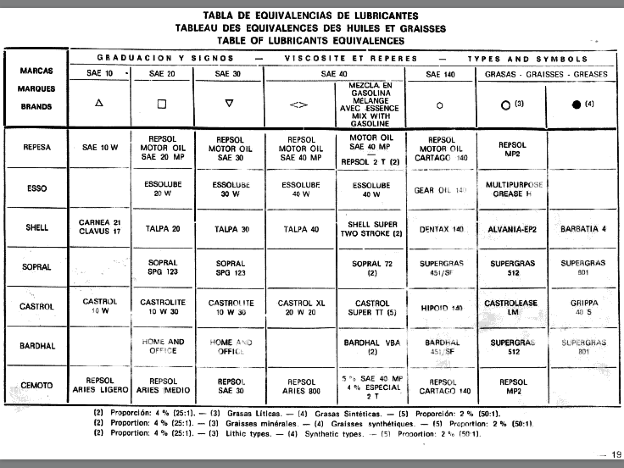

I've attached a photo of a page from the original factory owners manual
Interestingly enough I see they recommended 140 gearbox oil. However I've always put EP90 in my Sherpa, as that is what we use to sell in the shop back in the day when I worked for the Irish Bultaco importer.
