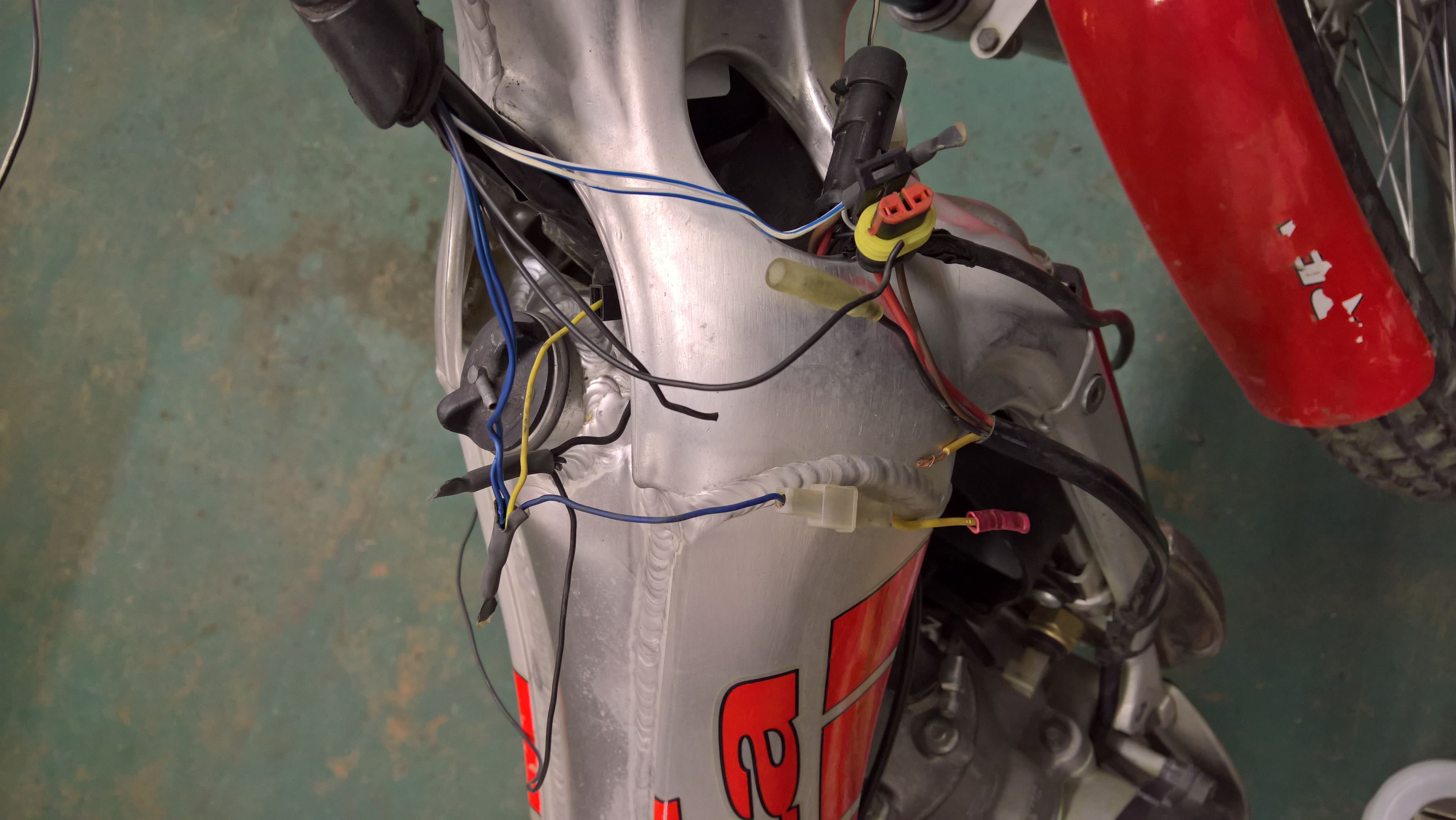

So much for my bike that doesn't need much doing!  I decided to remover the front light unit and fit a new 'yamaha YZ' style kill switch.  Having read a couple of posts on the topic, I didn't really expect any problems last night, however that was somewhat shortsighted of me......
Once I started to try to pull the wiring out of the R/H side of the tank bung, it became very clear that the wiring had been somewhat botched.  I expected to see a number of connectors that could be simply unplugged to allow the light unit to be taken away, but what I found was groups of wires twisted together and insulated with either heat shrink tubing of tape.  In some cases, the wires were of different colours.
Time to get the wiring diagram out of the handbook to trace things, but then another problem.  The wires out of the generator do not match the wiring diagram.  The 2008 model diagram I have in the handbook, shows 2 yellows coming out along with a white, a black, a red and a blue, whereas mine has a single yellow, a brown, a red and a black.  This looks the same as shown in a 2006 handbook.  I am convinced the bike is a 2008, but has it had an earlier stator fitted?
I have attached a picture showing the wiring once eased out of the bike.  You can see how the single yellow charging wire was poorly connected to a a single spade coupler which is then connected to a blue wire that feeds into a small bunch of blues, along with a yellow, which goes down towards the fan motor. Now I know the blue wires feed/fed the lights and horn and these are coming out, and I also know that yellow has to feed yellow for the fan to work, however the SWG of the feed from stator is much greater than the wire to the fan motor.  Is this correct of has a lighter wire been fitted to the fan?
Any suggestions would be appreciated with regards to the wiring and the generator/stators.  It will be nice and tidy as well as secure when I have finished.  I hate bodged wiring :angry:

Thanks.  I had read that comment somewhere else, but back in 2009, 'Fergush' posted on this thread about light removal
and as the instruction was quoted as being from Lampkins, I though all would be well. Trouble is, the instructions are next to useless, if the wiring had previously been messed with by the equivalent of a 3 toed sloth wearing welding gauntlets!
I think now it would be best to talk to Lampkins and see what they say about the mess.
I think the older bikes ran the lights off the rectifier and the '08 ran the lights directly off the ac output of the lighting coils and only used the rectifier/regulator for the fan motor if I remember mine correctly. The also provided ground for the lighting circuits through a lug on the top triple clamp which is a huge mistake.
I finally got round to phoning Beta UK and have to say, they couldn't have been more helpful.  I now know that all of the replacement stator packs on the shelf, have only a single yellow wire as the power source, so nothing to worry about, apart from making everything nice and tidy. I will ensure that I provide a good earth, probably to one of the coil mounting bolts.
