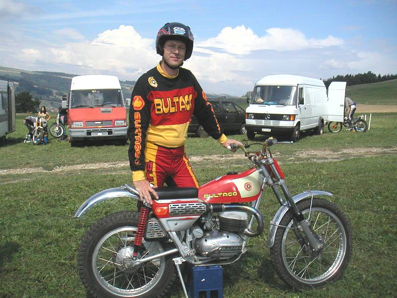

Nice to hear about another M49. Mine was bought by my father and I rode my first regional trial with it at 15 years back in 1979.
I restored everything in 2002, rode one round in Moudon Switzerland behind magical Mick Andrews (what an honour for me...) and since then in France at AFATA trials.
The muffler: Mine is still original, looks small, but without it, there is an ugly sound, not really nice and power delivery does not improve.
I really recommend to ad something.
Another useful item was a leonelli electronic ignition, power + 25%, engine never stoped since, although about 400EUR, well invested money for me.
regards
Patrick from Switzerland

You may weep if you saw how unusual mine looked when I bought it so I won't send you any photos until it looks more like a M49. It had been fitted with a road bike dual seat, huge front and rear road-bike type footpegs mounted on heavy steel frames, the rear frame loop had been bent down to allow the double seat to fit better and the tank and side covers had been painted pale blue with a white flash to resemble a 1978 Pursang. The good part is that the bike is generally in quite good undamaged condition and runs well. It still has an old chevron pattern trials front tyre and the original aluminium front mudguard and mounting stays. I was able to buy a correct seat with a good base and a spare tank and set of sidecovers and am still deciding which tank to use. It is very good to see such clear photos of a bike such as yours for when I paint the tank and sidecovers. Yours is the first I have seen with "BULTACO" on the sides of the fuel tank. Was that standard on yours?
