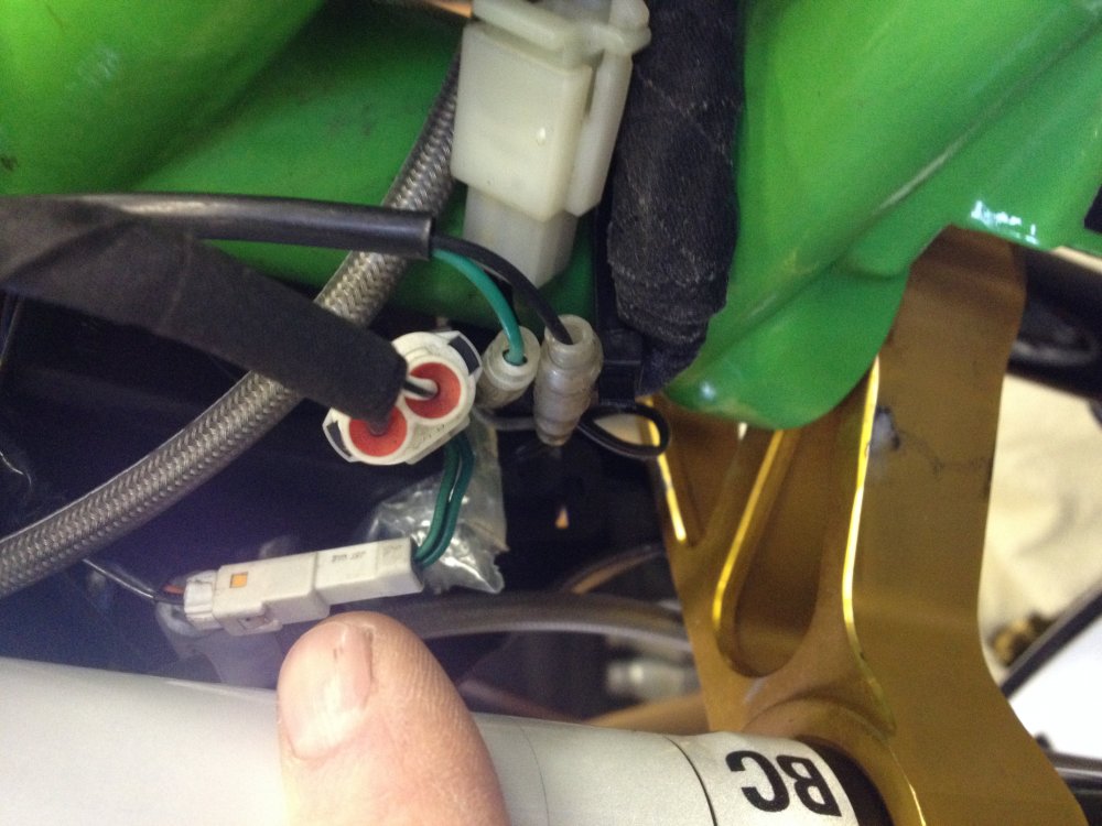

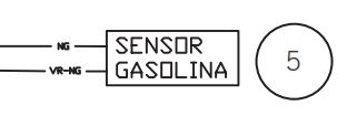

drevil Posted March 14, 2017 Share Posted March 14, 2017 HI, Can anyone help. I have a 2013 Ossa TR280i and i have notice on the LHS of the bike there are 2 wires not connected and without a connector. Upon closer inspection they appear to be Green and Black and i think they should be connected to the Sensor Gasolina. Can anyone shed some light on the function / location of this. The bike runs fine ! Quote Link to comment Share on other sites More sharing options...
jsp Posted March 14, 2017 Share Posted March 14, 2017 (edited) I think there is a level sensor in the tank on the rear brake side near the throttle body, but I think the wires just end up behind the light, you could buy a small light to act as a low level sensor but I dont know how it worked Edited March 14, 2017 by jsp Quote Link to comment Share on other sites More sharing options...
elemetal Posted March 14, 2017 Share Posted March 14, 2017 That is exactly what those two wires are for, 2013 and before didn't have the light (as shown). You can run any small bulb or buy the actual one, pretty sure it goes out when the level is low (opposite of normal). Quote Link to comment Share on other sites More sharing options...

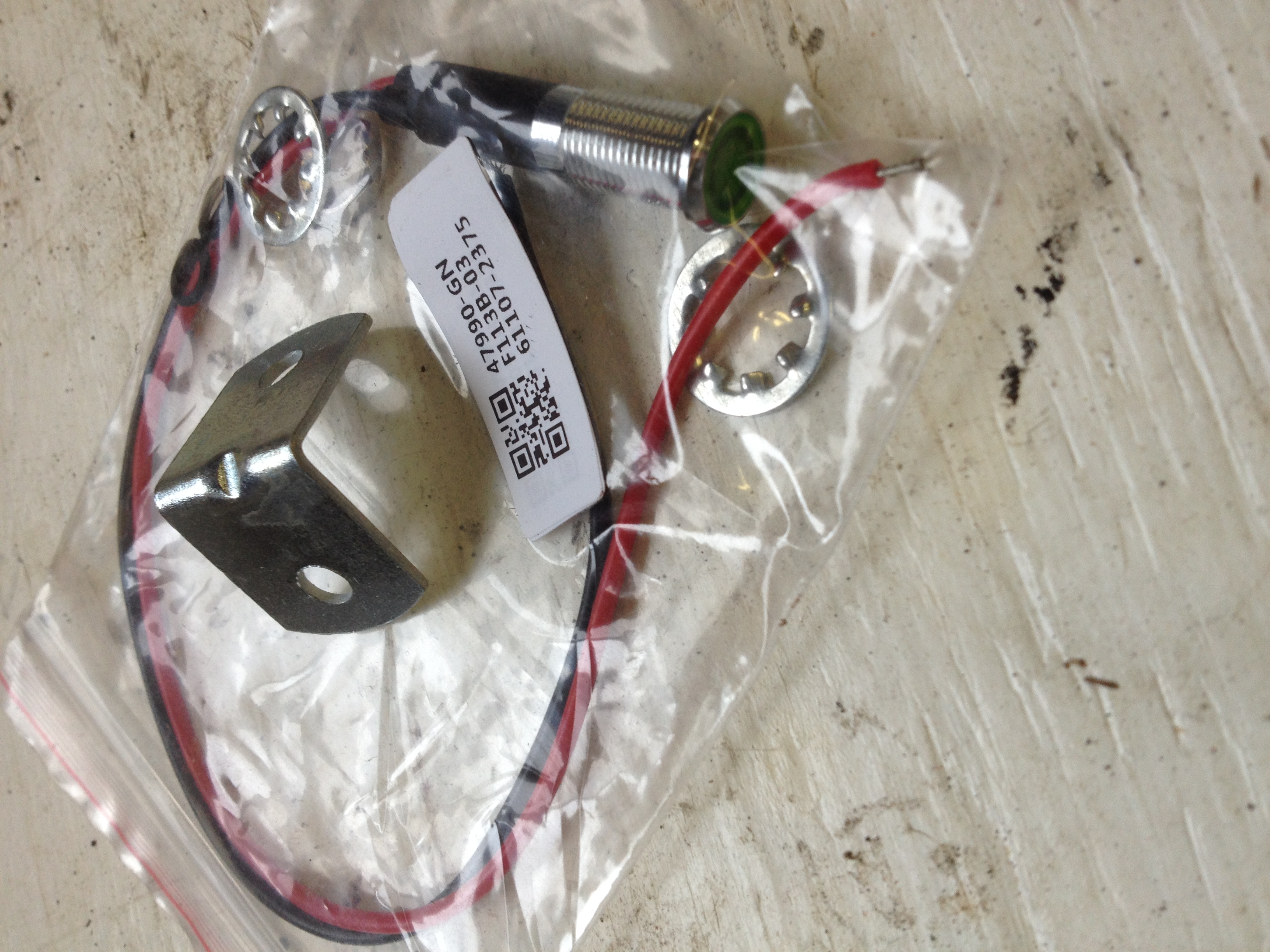

ossabc63 Posted March 14, 2017 Share Posted March 14, 2017 Thanks elemetal i bought a small green led off of ebay and wired it in using the unused connector end at the head light. But the lights on all the time, if i disconnect the connector at the sensor lights out. Never thought the dummys would wire it backwards, have to drain the tank down to check. ? Quote Link to comment Share on other sites More sharing options...

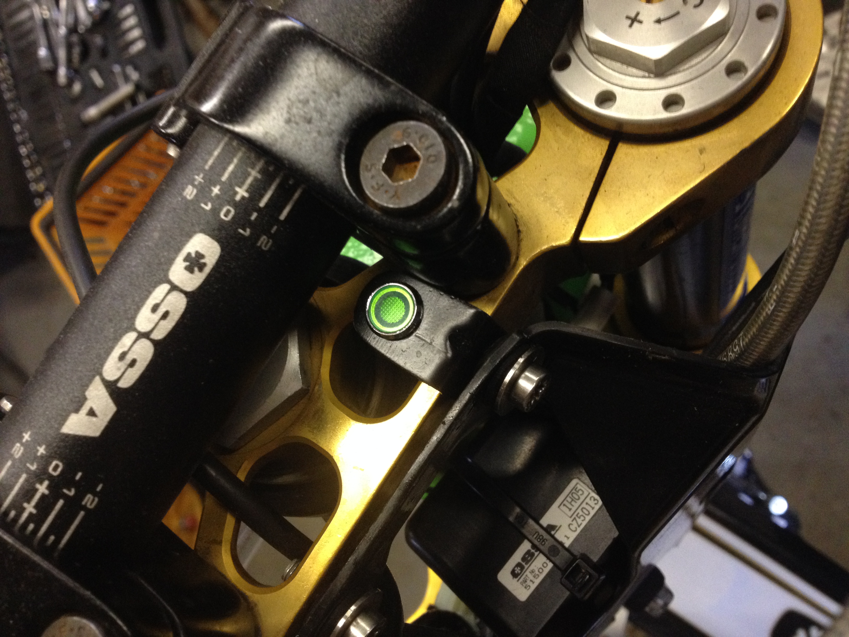

ossabc63 Posted March 16, 2017 Share Posted March 16, 2017 Jsp here is my setup the wire is a female connector with a black wire and a black wire with green tracer. The connector i cut off one of the unused connectors on the factory harness. Solder and shrink tube to the led light. Quote Link to comment Share on other sites More sharing options...
jsp Posted March 16, 2017 Share Posted March 16, 2017 brilliant thanks Quote Link to comment Share on other sites More sharing options...
