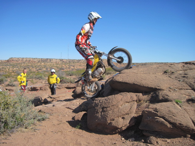

 The ty80 can be made to fit with custom peg mounts, taller bars. We actually have a ty80 class in our vintage series. This is my 6 foot 4 inch tall boy.

Modding the TY is definitely an option as I like my classic stuff and messing with bikes. I have seen a White Hawk version for sale which looks bigger would this be more suitable ?
Yes, my son actually rides a Beta 300 4T. When he was ten years old he was over 5 foot and growing fast. I made my own peg mounts and used tall ATV bars. We sold his bike and soon the new owner realized an adult could actually ride that TY 80. We now have around 10 guys riding the TY80 class just for fun.
