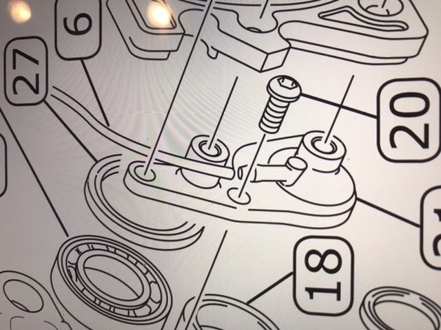

Mines never done it before, but I have had an issue with oil coming out of the breather pipe in to the airbox, I’ve now got two breathers fitted one on the kick start side where it should be and one on the sprocket side where they where on the earlier bikes and that’s stopped it coming out the breather
Do you have a picture on that pipe on the sprocket side?
Found this from a 2017....

yes that's the one, I cant take a photo as I've not got that bike now
Edited by jsp
Do you use an old primary shaft cover with the breather pipe or did you make your own pipe?
  • 3 weeks later...
sorry the work was carried out by Vertigo Uk but I think they fitted and older style
primary shaft cover with the vent build in
Ok. Thanks?
