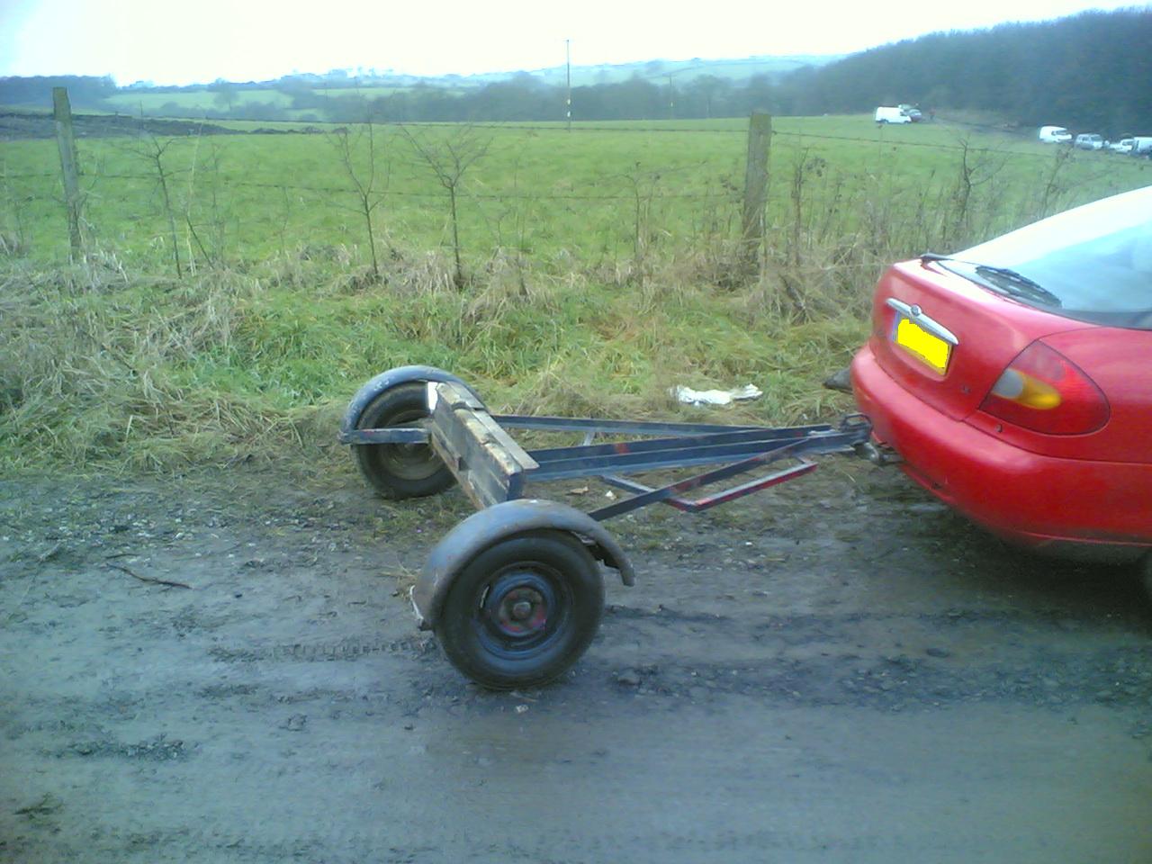

Maybe this is what your looking for, a week of that parked outside the house and your old trailer will be fine :D:beer:
