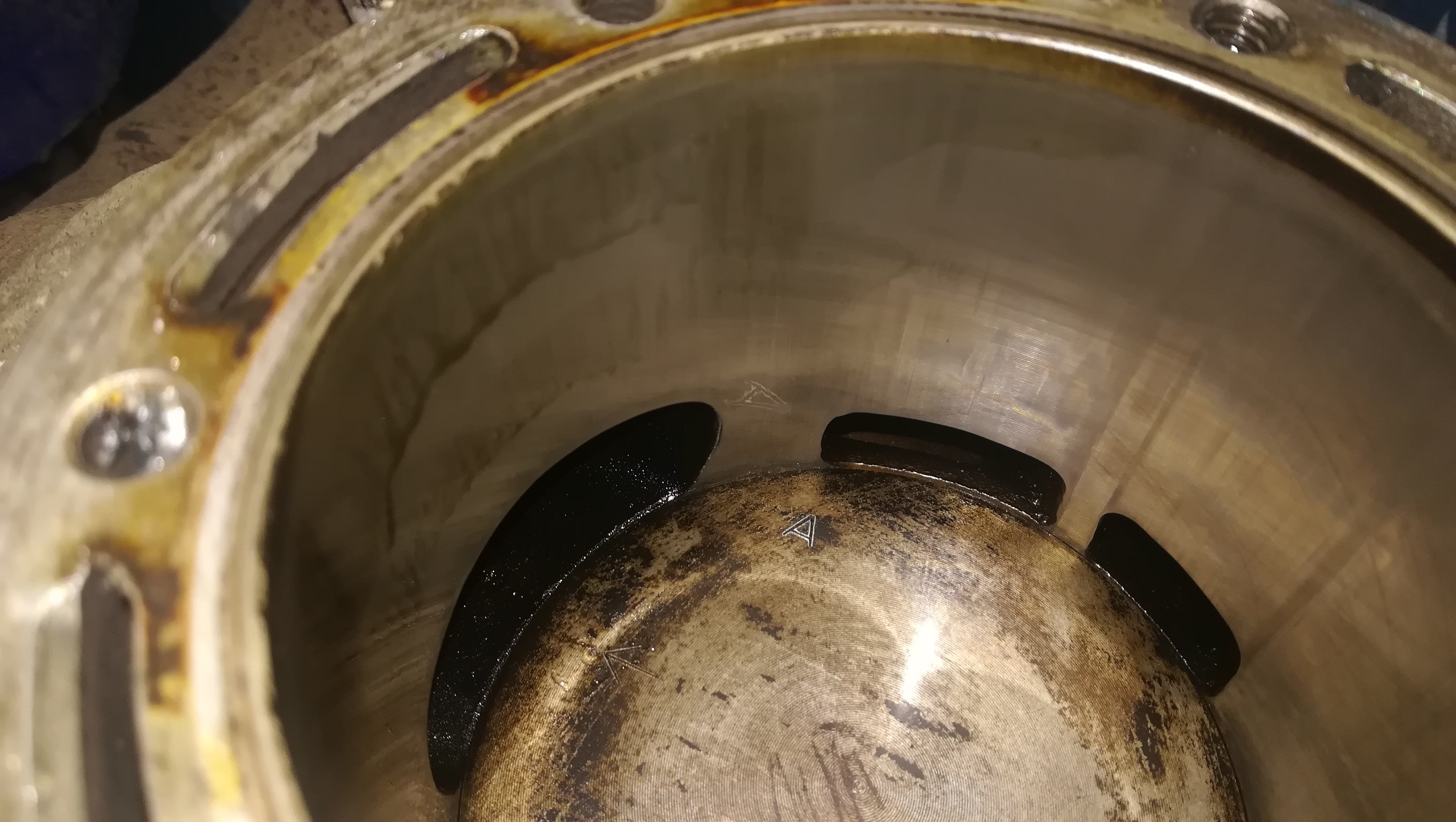

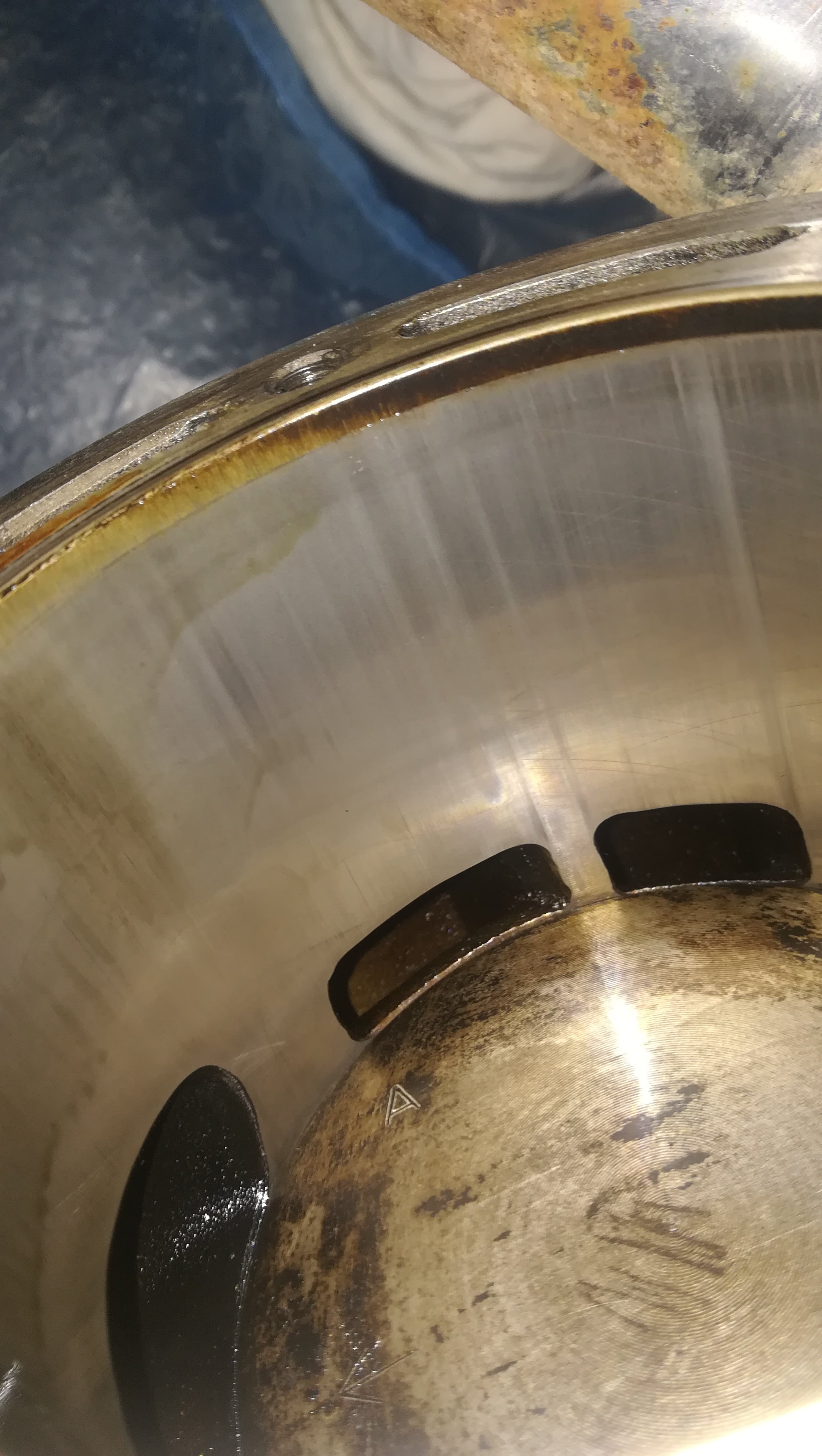

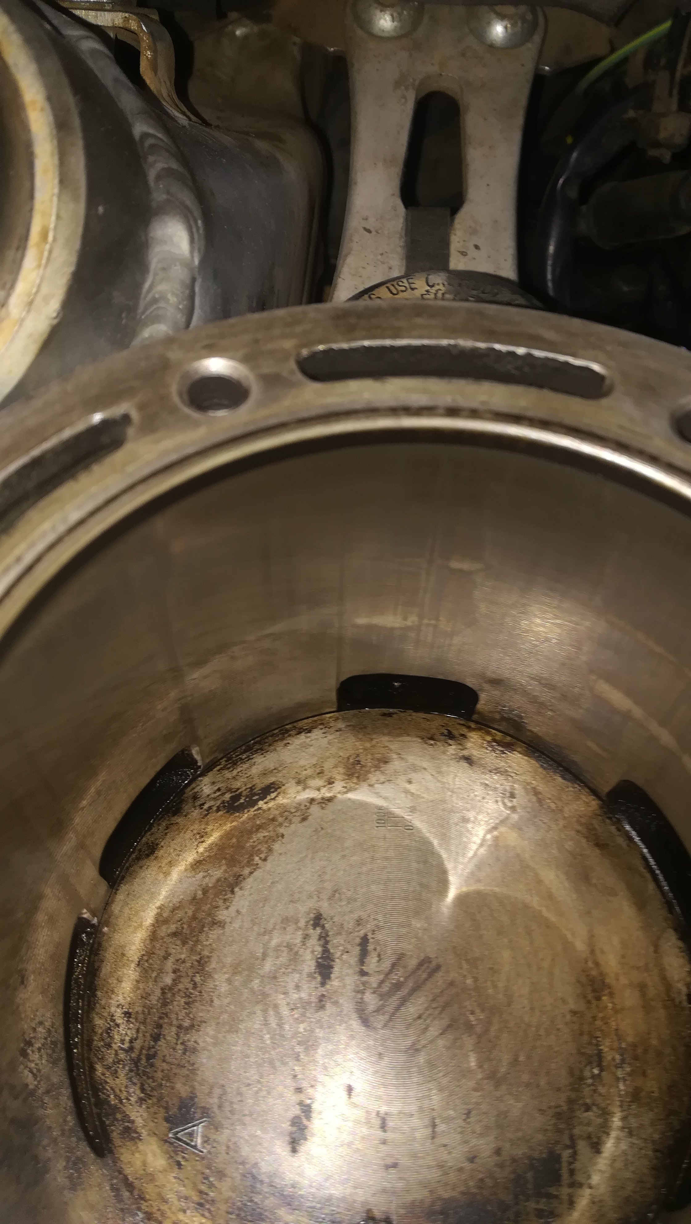

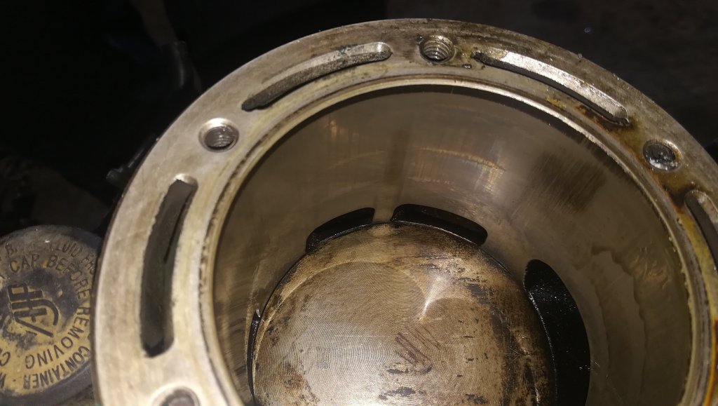

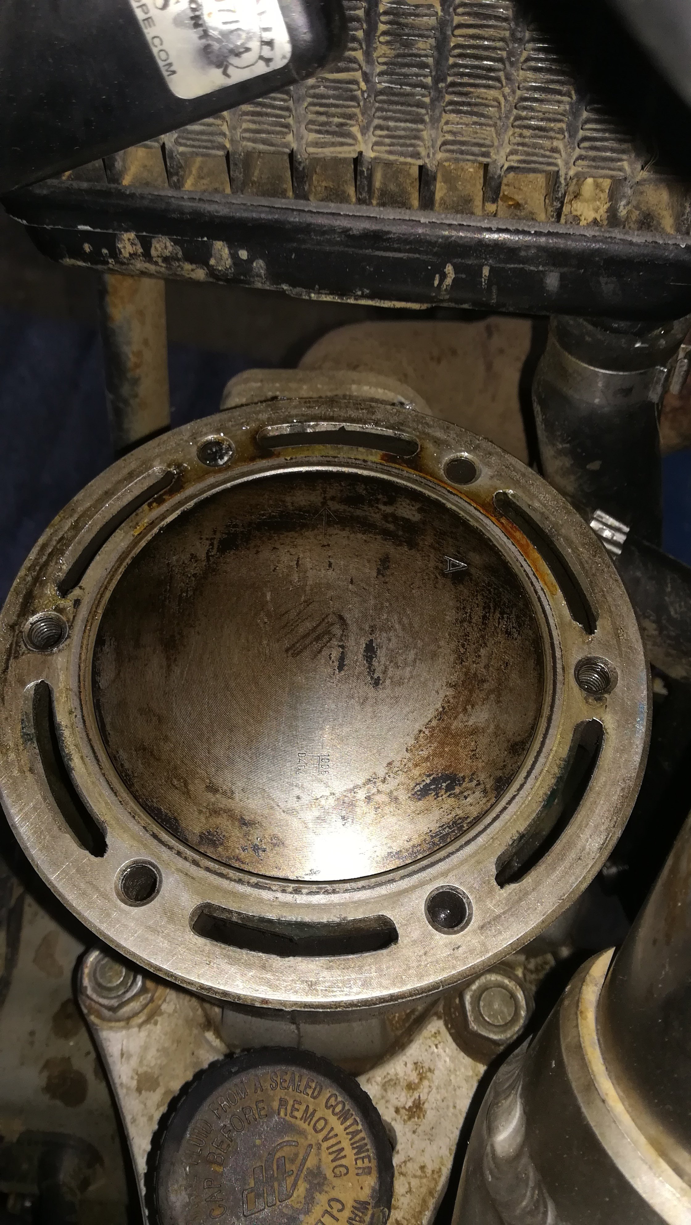

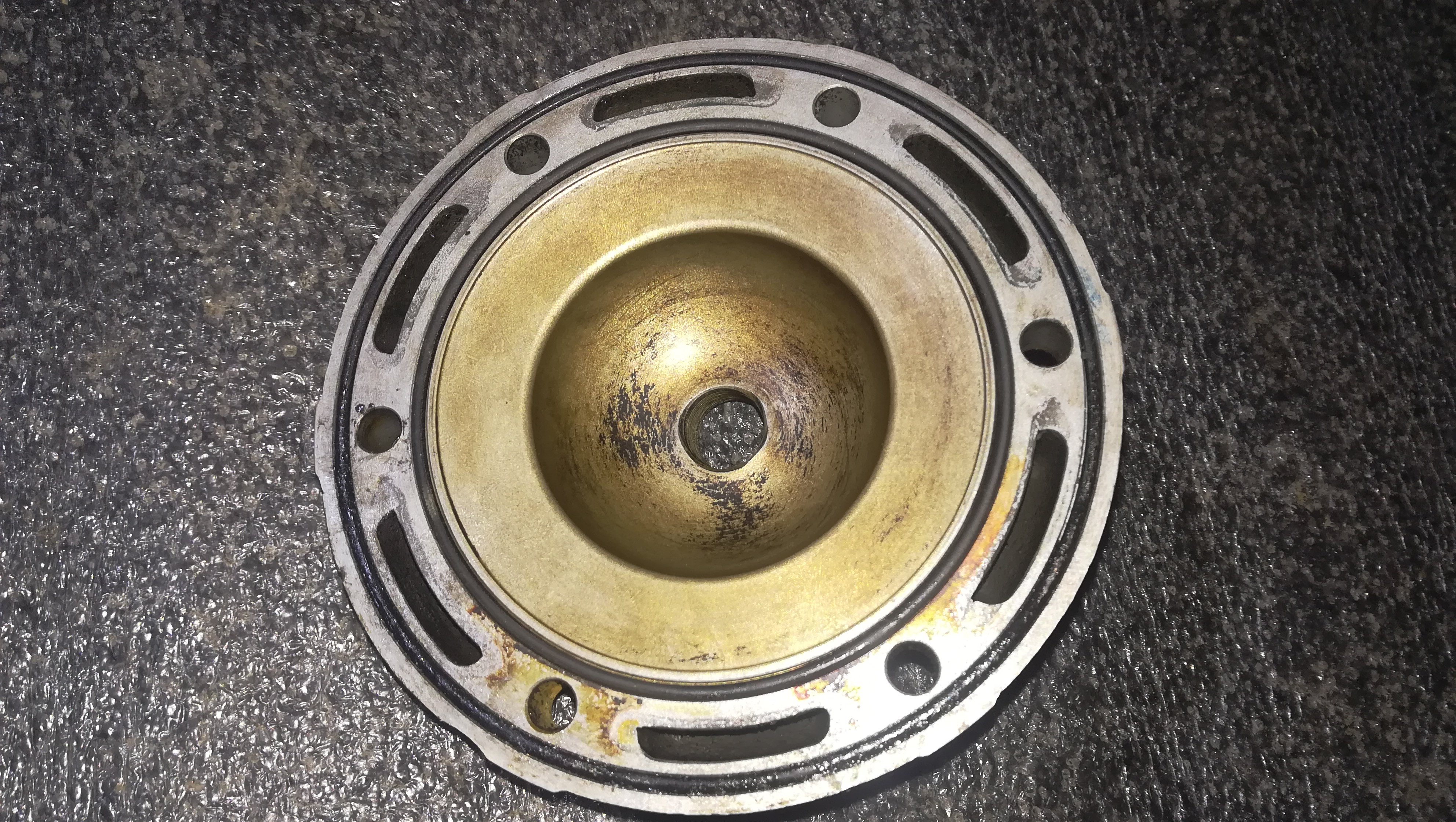

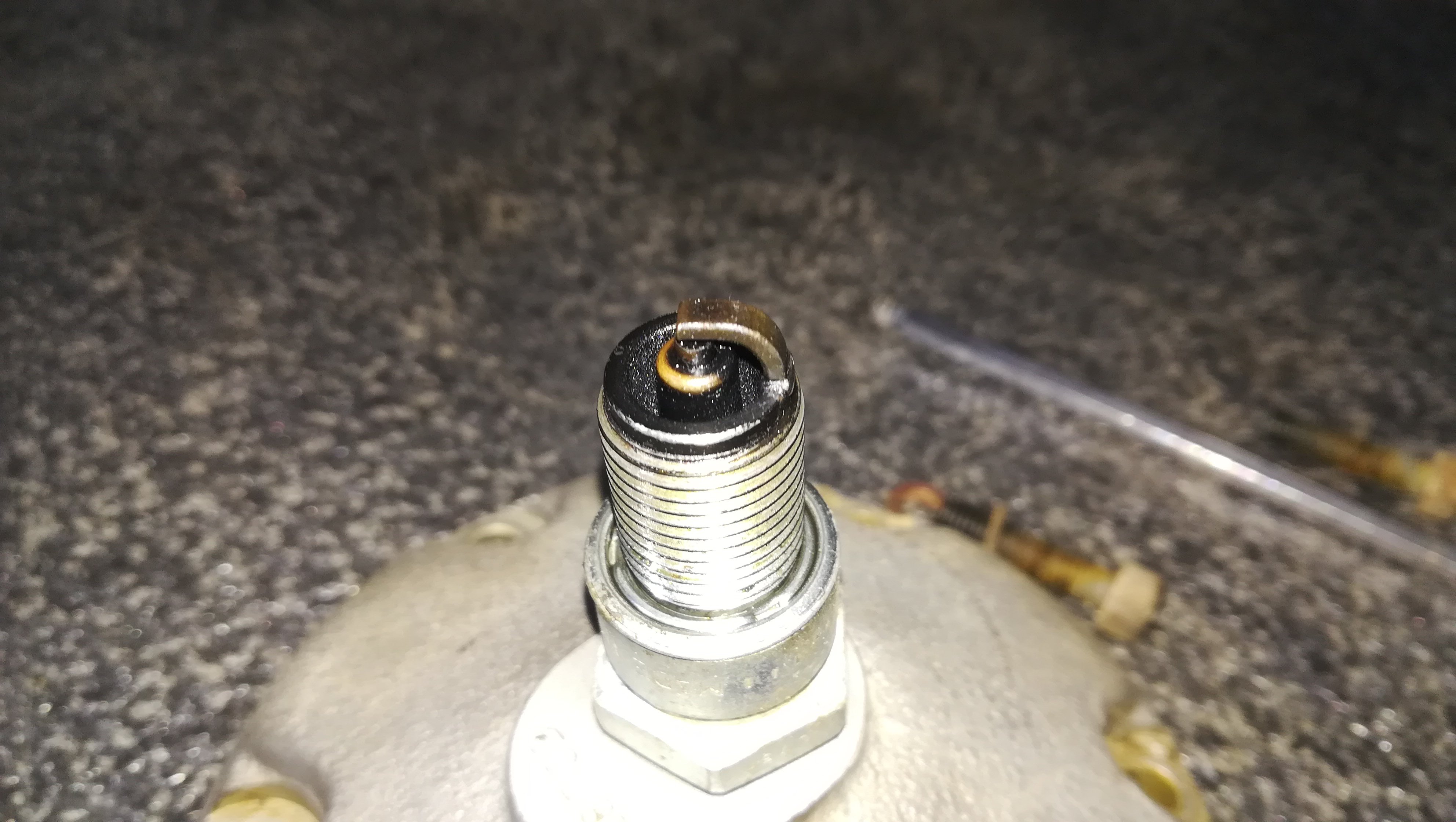

@lineaway & @section swept  took the cap off the engine, pictures attached; before I took the pictures I noticed that the piston top and the cap inside had a black coating, pretty tick, which I took off using a brass brush, but you can see that some of it still remained - is this normal, what is that coating? I took photos of the cylinder from all the angles that I could, I hope they help; please tell me i I have to go further and take the cylinder off to check the piston and rings.

 I would have liked to see a pic, before you cleaned it up. From the second picture it looks like the cylinder was leaking into the water jackets. I would pull the cylinder off and have a good look at the piston and rings. With using H1R, chances are your rings are just stuck as Bel Ray products leave a real gummy residue. (I used to get all B.R. products cheap and loved H1R until I saw the insides of my motor.) You will need to remove the rings and clean up the grooves.
 So you will need a base gasket, and orings. Rings if you feel like it. Two things to check while going back together would be the water pump and make sure the fan is working properly. Good chance the fan is not coming on all the time. When they start going bad you can spin it to get it started. Good luck, I`m going riding.

Carry out all of the checks that lineaway has suggested, plus drain the crankcase and also clean the radiator matrix, those fins look like there is mud in between them.
Your spark plug will appear wet if you start the engine, run it and then shut down as no resl hest will have been transfered to the plug tip area...thats a plug chop exercise...Google it saves me writing??

I suggest that you also verify that the piston is installed in the correct orientation; you want it so that the ring retaining pins (and hence the ring ends) do not pass any port openings in the cylinder (where they might catch). Normally, a piston will have a mark (typically a "V") stamped on the crown, and that's to be oriented towards the exhaust port. I can see an "A" on your piston which corresponds to the size (first oversize), but I don't clearly see the "V". Or maybe the "V" is there amongst the other lines/marks. Just have a look.
I will be obvious when you remove the jug as to whether or not the piston is installed correctly; you want the ring ends towards the rear-half of the jug,
