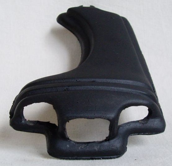

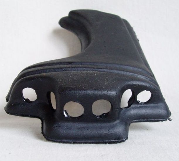

There are a few mods you can do to stop the silencer oiling so much. Here's what we did with our 2005
Go hotter in the spark plug. We used a NGK B8ES mostly but sometimes went with a 7 in cooler weather.
Open up the airbox lid so it breathes a bit better - pic below.
Leaned the needle position. Clip was in position two from the top.
Play with the mixture screw once you've changed the needle and opened the airbox lid. I ran the idle a little higher to help stop stalls.
I don't want to start a fuel oil debate, but as soon as I stopped using Motul 800 oil (first in Shell optimax and then in BP Ultimate 98) I found less jetting hassles and much less oiling issues. We now use BP Ultimate with BelRay H1R at about 80:1 (62ml per 5 litres)
The 50 ran cleanly and with a near perfect plug with the above settings (slightly sooty on one side sometimes) and I had to replace the silencer packing much less after that. Even so, every so often I gave it to the older boy who gave it two or three laps around the MX track at higher revs.
Oh I ended up squeezing on a second o-ring to seal the silencer to the pipe, sometimes with a smear of that blue silicon.
Got our 2006 model Rev 50 yesterday. It seems to idle much more smoothly and is much more responsive at low revs. I did the aibox mod but everything else is stock. We are running-in at 70:1 with the above fuel/oil. It runs very smokey.
Hope this helps
