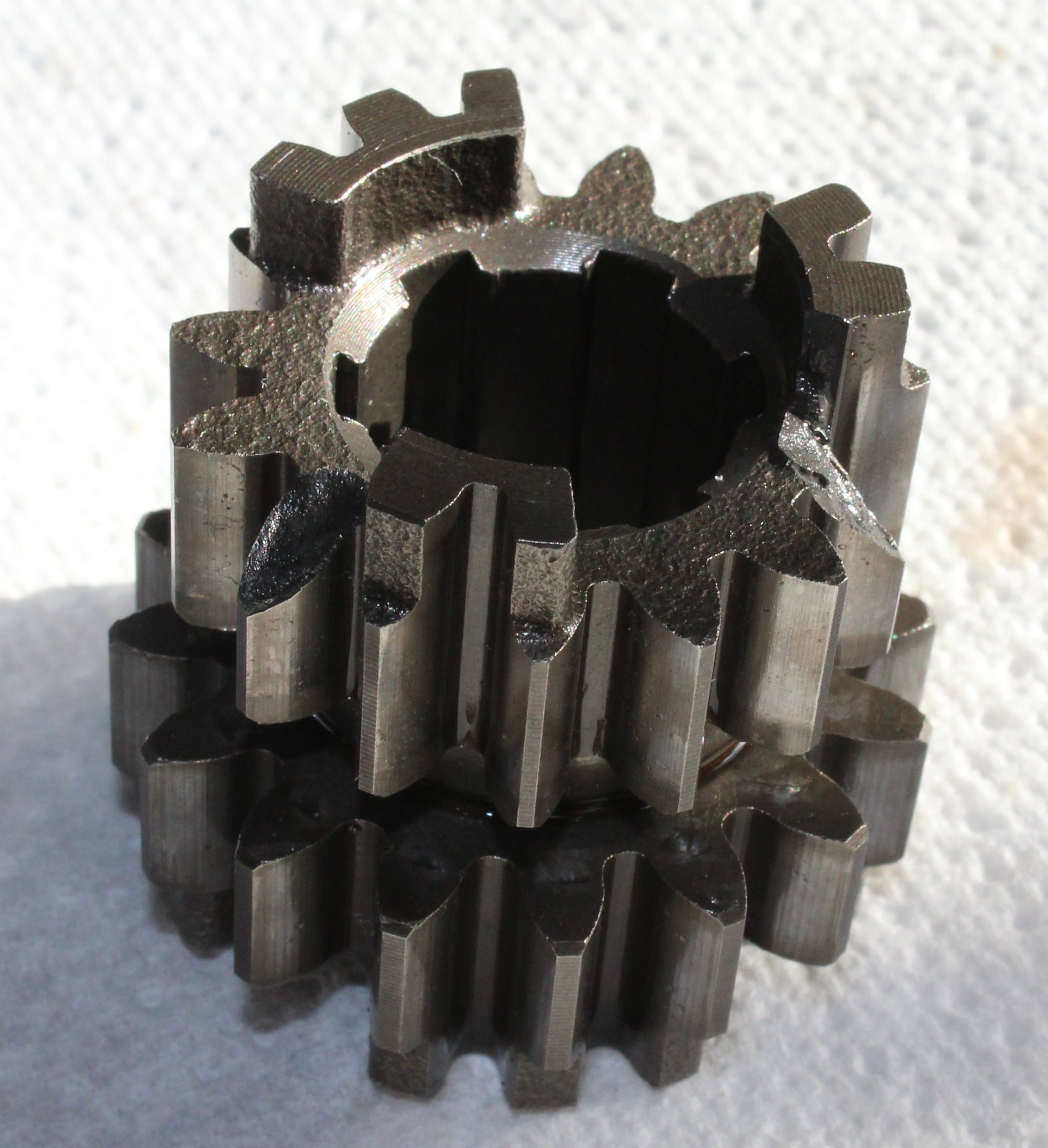

With the cases apart the cause of my problem was evident.; two broken dogs on the sliding 2nd/3rd gear on the mainshaft.
Have ordered this from Beta along with a new water pump shaft.
As everything else looks OK I am just going to replace all the gaskets and seals that have been disturbed.

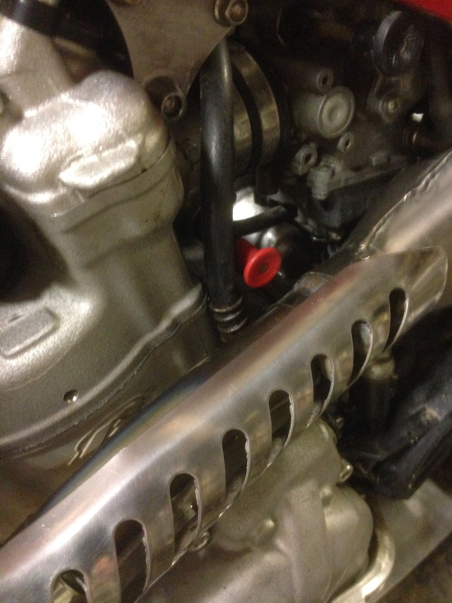

  • Moisture had got in under the stator cover and rusted one of the screws of the water pump cover.  Had to drill and use an extractor to remove.  I will be keeping an eye on this and drying regularly in the future.
What I did with my stator cover I drilled a hole in the outer part of the crankcase tuned up a spigot the right size for a plastic pipe and glued it in with arldite sealed the stator and had never had corrosion inside in two years
