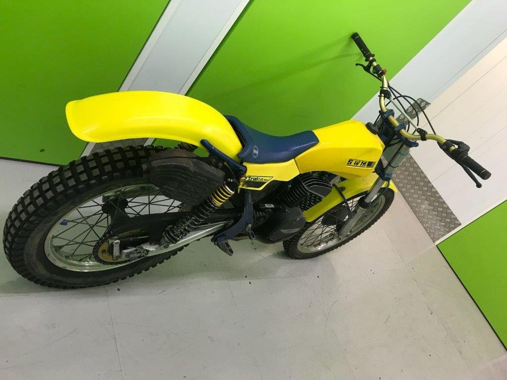

Hello, I'm Xavi from Barcelona, I have a SWM 320TL NW from 1982, I just put a Climber motor and now I'm looking for an aluminum swingarm model 1983. Could you help me locate one?, I contacted Martin but a long time ago that you do not have any… Thanks a lot

Yes, the photograph is before the engine change
