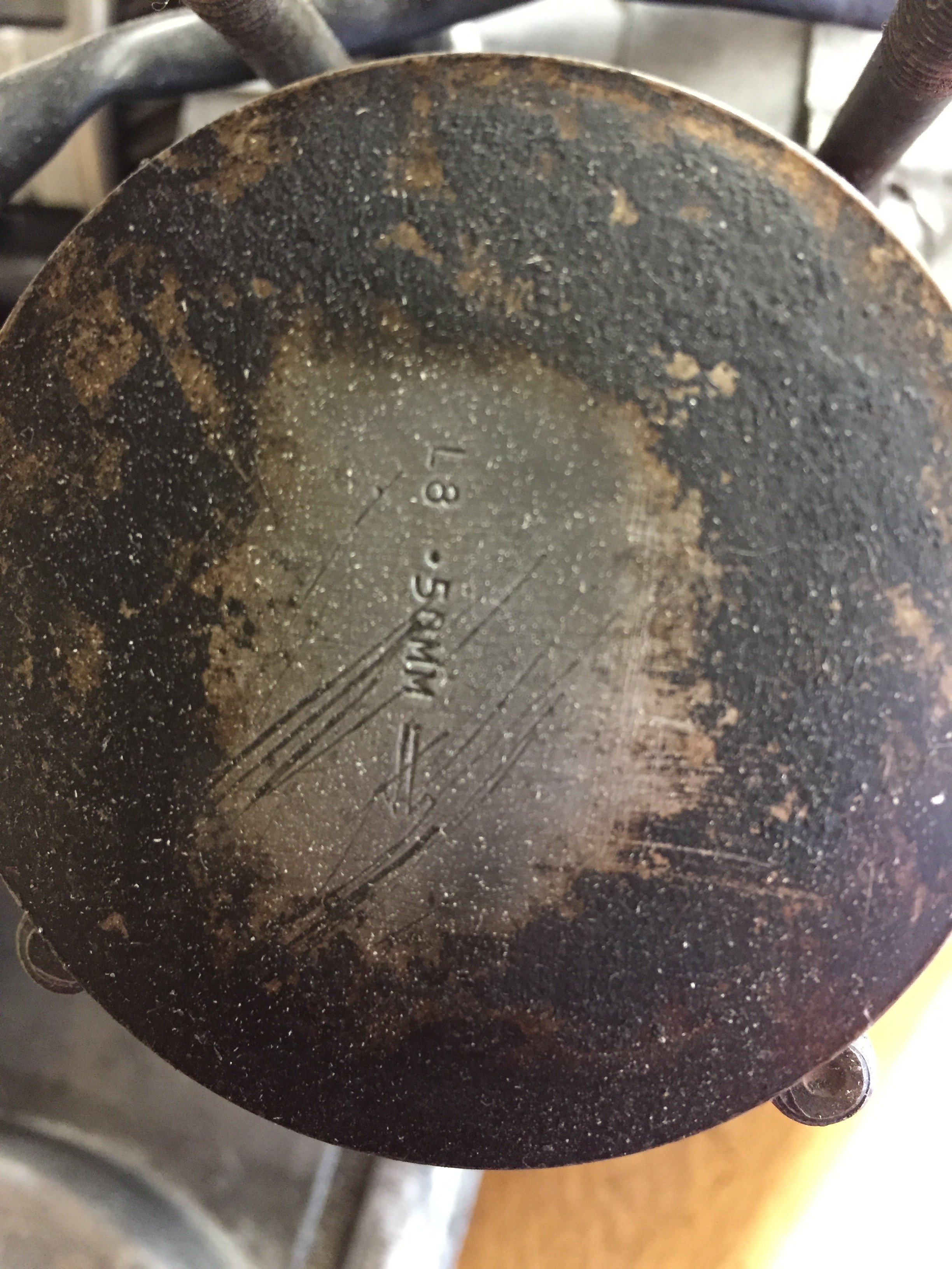

 Hi guys back again for some more advice on my TY175 I am rebuilding the engine and wondering whether I should fit an oversized piston. The original problem was a very noisy Rattalee engine  coupled with loss of power. The writing on the piston is clear in the picture any advice would be most welcome?
If I'm not mistaken your piston looks to be 2nd oversize  over stock. The correct procedure to do would be to measure (or have it measured) the cylinder bore at different spots to see how much taper or out of round it is. A shop manual will give the correct specs for measuring.That would tell you for sure where you need to go as far as a rebore and oversize. If the engine runs very rattly also check the main bearing play by trying to wiggle the crankshaft flywheel.If you detect any movement you will probably need main bearings... and while you have the crank out might as well have a new rod pressed in for good measure. You don't want to do any work you don't have to obviously but don't short cut it either..

The piston numbers say that the piston is 0.5mm oversize (0.5mm bigger than standard). From what you have said, you should have the cylinder rebored to a larger oversize. Which oversize to use can be determined by measurement of the cylinder by someone experienced at the job (usually the person who would be doing the rebore work)
Some brands of pistons are available in size steps of 0.25mm and some brands are available in steps of 0.5mm. The biggest piston kit available is 2.00mm oversize. Unless your cylinder is extremely worn, you are likely to only need to increase the piston size to 1.00mm oversize. Don't buy a piston kit until you have had the cylinder measured.

a picture of the bore and side of the piston would be helpful, worn little end & big end bearings can make an engine rattle. and worn rings.
Thanks for your advice one and all. I’m taking it to my local machine shop for measurement before I go any further. Many thanks.
