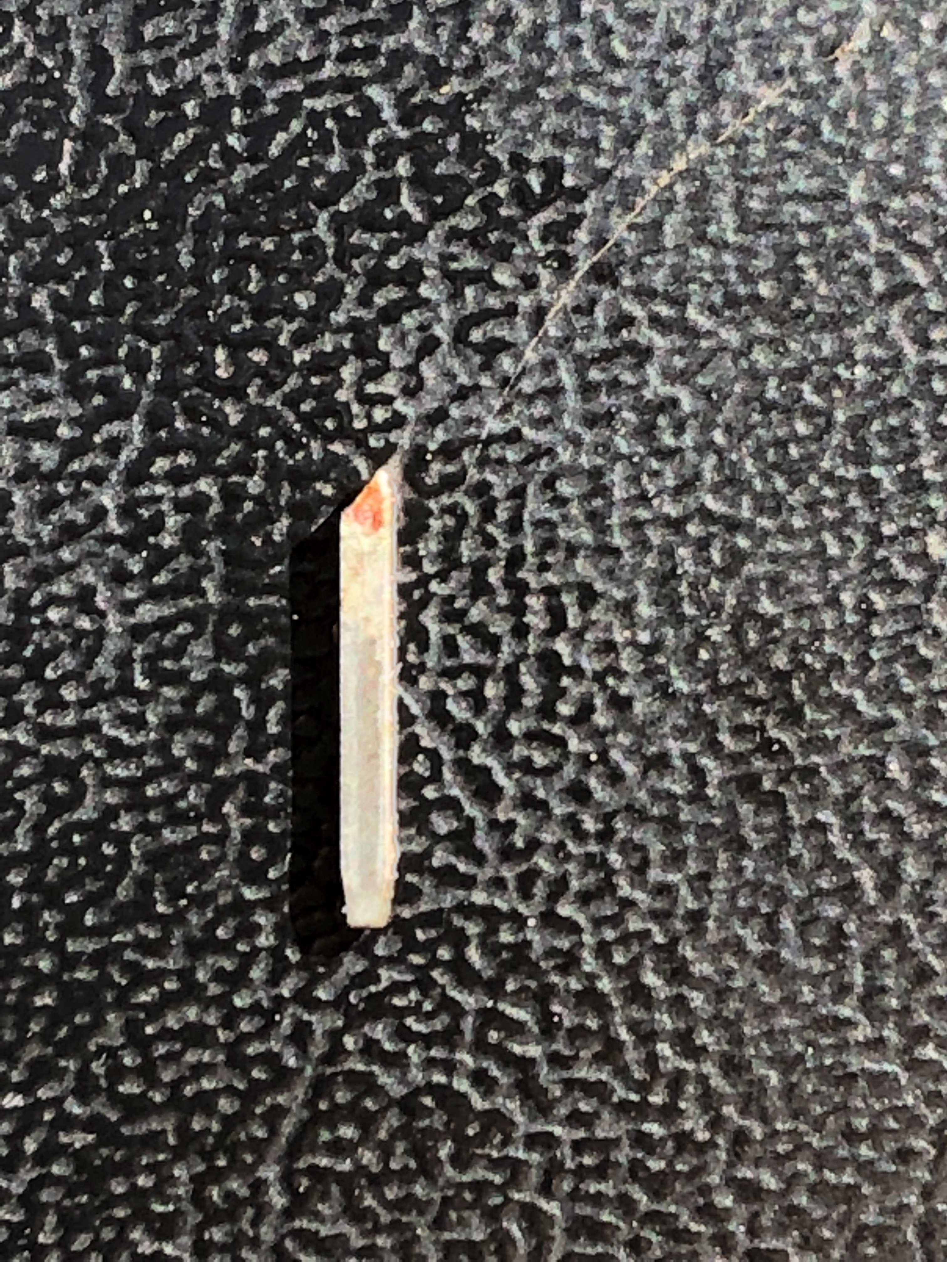

June 3, 20197 yr Author Found it! After careful inspection again. I discovered a pin on the ECU corroded and broke off. I didn’t see it earlier because it had broken off flush so it was not visible. The pin was stuck in the connector. It is broken flush so I don’t think I can repair it. Now the million dollar question. Where can I get a replacement ECU? I’ve googled w no luck. If anyone has a line on one or have one willing to sell, please let me know. Hope I can find one. Thanks!
June 3, 20197 yr Good fault finding skills Viper. Spare ECU's are hard to come by. I would try to make a repair, would not be pretty but it would work. Using a Dremel type mini die grinder, with a fine tip router bit, work away at the plastic/potting around the broken pin to reveal more of the pin, very carefully tin the pin (don't leave the heat on too long). Drill a small access hole to the right of the broken pin in your photo for a small diameter insulated wire, tin the end of the wire, feed through the hole and very carefully solder it to the pin. Solder another wire to the cable going to the socket (female connector) that lines up with the broken pin, then connect these two wires using an in-line connector so you can still connect and disconnect the ECU plug. If you like, I can pop over and do it for you, if you pay the air fare! Bye, Peter B.
June 3, 20197 yr Author 10 minutes ago, peterb said: Good fault finding skills Viper. Spare ECU's are hard to come by. I would try to make a repair, would not be pretty but it would work. Using a Dremel type mini die grinder, with a fine tip router bit, work away at the plastic/potting around the broken pin to reveal more of the pin, very carefully tin the pin (don't leave the heat on too long). Drill a small access hole to the right of the broken pin in your photo for a small diameter insulated wire, tin the end of the wire, feed through the hole and very carefully solder it to the pin. Solder another wire to the cable going to the socket (female connector) that lines up with the broken pin, then connect these two wires using an in-line connector so you can still connect and disconnect the ECU plug. If you like, I can pop over and do it for you, if you pay the air fare! Bye, Peter B. Peter thank you! That is brilliant! I’ve been thinking how I could sleeve and resolder the pin back on. But the wire idea is easier and certainly more dependable. I’ll give it a shot. Actually I’ll have my jeweler give it a shot. Any tips on the method or type of solder to use? If he can’t do it I’ll find out your availability for a trip here to Hawaii! Will let you know how it works out! Thanks ks again.
June 3, 20197 yr I'm feeling a bit sheepish now for having said the signal out of the ECU was unlikely to go bad (I was thinking of just the internal circuitry -- had not considered a broken pin). It's impossible to tell from the photo, but is that pin 17 or 18? (numbers are on the back of the mating convector). Pin 18 is for the injector, but pin 17 is switched 12VDC out of the ECU (which you may be able to work around). An obsolete electronics solder that contains lead would by my choice with a rosin-core flux (if it comes to that). P.S. If you destroy the ECU, don't throw it away. I've been wanting to get my hands on a dead one! Edited June 3, 20197 yr by konrad
June 3, 20197 yr Author Korad, thank you again. Performing all those checks you suggested ultimately lead to me discovering the fault. It ts pin 18 which is at the very end of the row. It should be easy to access through a hole drilled through the side. I’ll let my jeweler know about the lead solder. If he doesn’t have any I might look around to pick some up for him Edited June 3, 20197 yr by Viper808
June 4, 20197 yr I'm feeling a bit sheepish now for having said the signal out of the ECU was unlikely to go bad (I was thinking of just the internal circuitry -- had not considered a broken pin). Hi Konrad, baaaaaa ?????? (Strange Yorkshire humour) Hi Viper, the old standard solder for PCB (printed circuit board) work is 60/40 tin and lead which should have a rosin core, the rosin acts as a flux to keep the joint clean. As lead is toxic the later solder wire replaced the lead with copper and other alloying agents. The 60/40 solder is known as soft solder as it melts at a reasonably low temperature, around 232C. I should bring some with me as your jeweller has mysteriously vanished! Bye, Peter B.
June 5, 20197 yr Seeing that corroded pin is really discouraging. The JAE connector used on the ECU is the sealed type. Is that connector's blue sealing gasket still present? Maybe Hawaii's environment (sea air) has something to do with it the failure? Prior to buying the OSSA, I weighed heavily the fact that most of its electronics were designed/manufactured in Japan (a huge plus in my opinion). P.S. I'm now wondering if the pin snapped off, and then corroded? Edited June 5, 20197 yr by konrad
June 5, 20197 yr Author Konrad now that you mentioned it I realized the rubber seal is missing. Pretty sure it has been corroding for a while and then eventually broke causing the no run condition. So update on the fix. Took it to my jeweler with the plan to grind around the pin stub and solder a wire to it. Instead he said he can remove the assembly from the casing and replace the broken pin all together. So I got it back new pin perfectly positioned. He said he used a paper clip ground down flat to match the shape of the pins. It was looking like new all resealed using jewelers epoxy. Excitedly got home and installed it. No start. I couldn’t even energize my fuel pump w my lipo easy start system. I think it must gotten fried with too much heat. I asked him to use 60/40 tin/lead and use as little heat as possible. Not sure if it’s worth opening it up again to see if a connection got broken as it was being reassembled. Oh well it was worth a try and a valiant effort! I might have found an ECU at Lewissport. Adrian is checking to see if he still has it. Will let you know outcome. Thanks!
