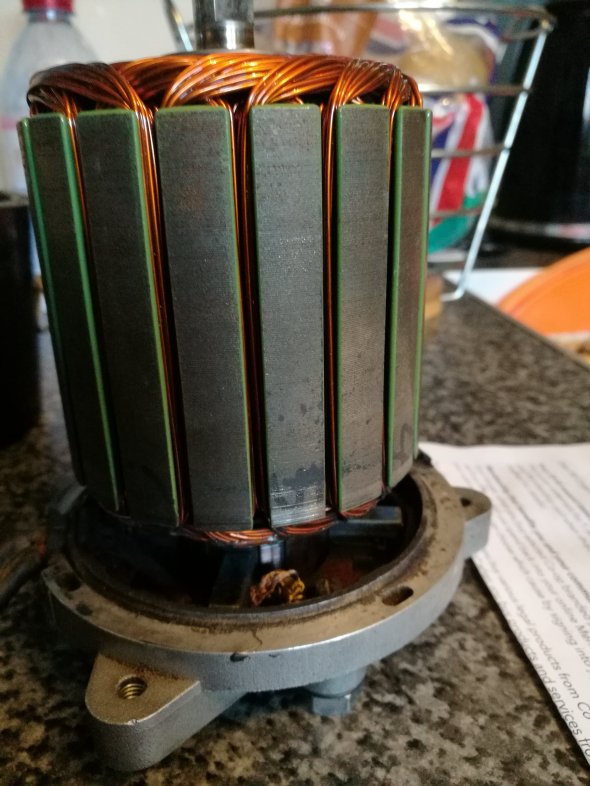

Hi guru's. Last weekend the motor started making a kind of grumble/snatchy noise once the motor had gotten hot. Switch it off, Have a cuppa, let it cool and all fine again. The bike is just over 18 months old and still running same bearings so I figured it was time to swap them. I have removed the Motor, pulled the sprocket off. Removed the drive side casing and then with lots of swearing and clever use of welding gloves and an inner tube, removed the housing. My problem is that now can't seem to remove the non drive side casing to access the other bearing. How do I remove this side?. I can see the brushes in place and the (stator plate?).. I can see down to the bearing, but tugging and twisting hasn't worked and I've purposely hidden my hammer. Am I missing something?. Any advice or information would be greatly appreciated. And also any recommendations on bearings?.
the armature should just pull out of the other bearing, be careful that you dont damage the brushes if the whole bearing comes out of the housing still attached to the shaft as the bearing will hit the brushes, try just tapping the mounting ears of the end cap while holding the armature in the air.. but dont go mad with the hammer :-).

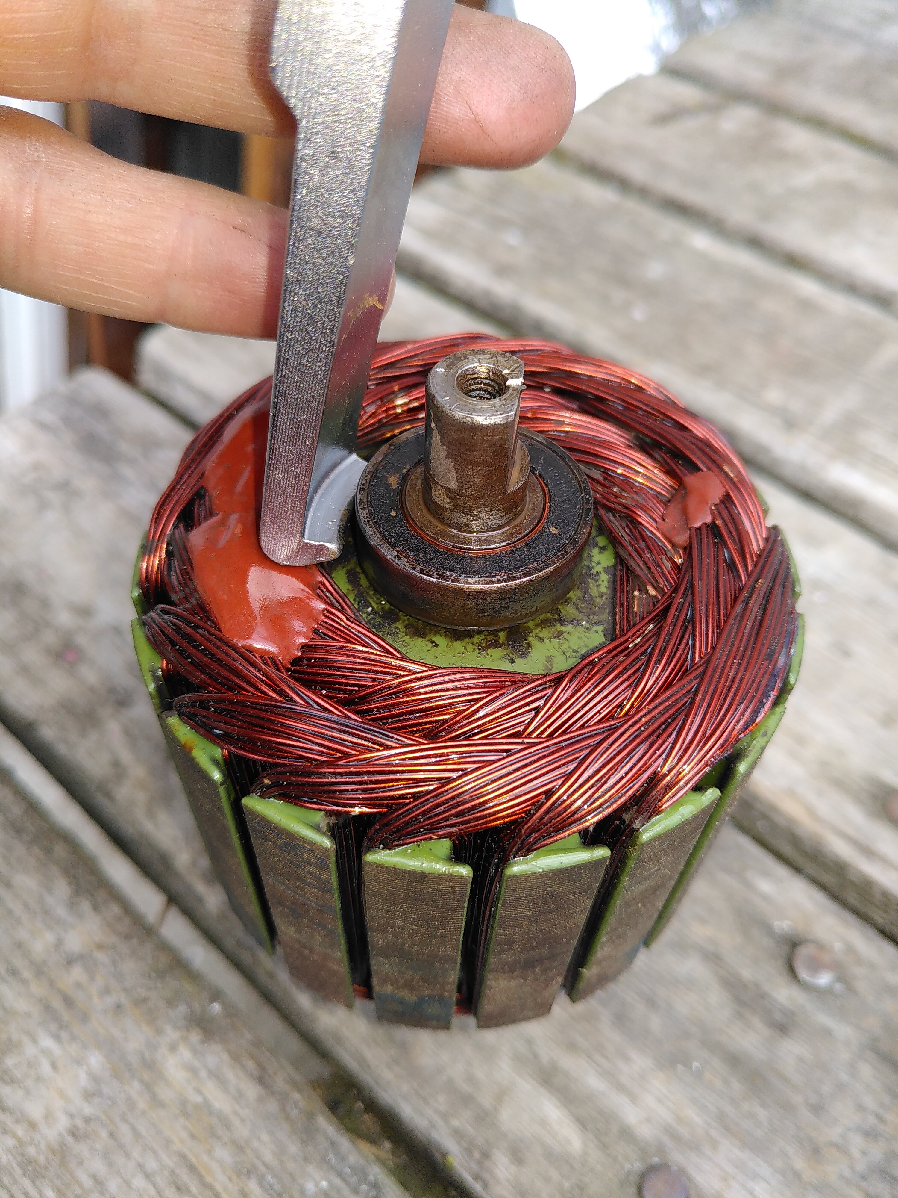

I have the 48v motor out of my sons 2015 20 lite. But I cannot find a way of removing the drive side bearing. I can't get a puller on it due to restricted access. See photo.
The bearing is totally shot, the back wheel of the bike can hardly turn. I figure replacing a £4 bearing has to beat a £360 motor!
I look forward to any help you can give.
